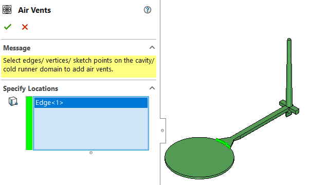

Venting Analysis
You can specify Air Vent boundary conditions on model edges.
In earlier releases, you could specify air vents for Venting analysis on vertices only. With the addition of edge-based air vents, you can capture more realistically the behavior of actual mold vents. You can assign the Air Vents boundary condition to Cavity and Cold Runner System domains.
