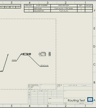

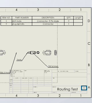

Automatically Scaling Drawings to New Sheet Formats A flattened drawing of a routing assembly The same flattened drawing, automatically scaled to a new sheet format When you change the sheet format template of a flattened drawing, each element automatically adjusts its scale and position to fit within the new sheet size. For example, the drawing in the table above remains centered after the sheet format changes from A3 Landscape to A4 Landscape. Benefits: Automatic scaling ensures that each element of your drawing adapts to a new sheet format correctly, saving time and reducing errors. Automatic scaling applies to each element of the flattened drawing, including: Drawing views Electrical tables Annotations Connector blocks Parent topicRouting Redirecting Guidelines to Follow a Route Path Managing a List of Favorites for Coverings Connector Table Enhancements
