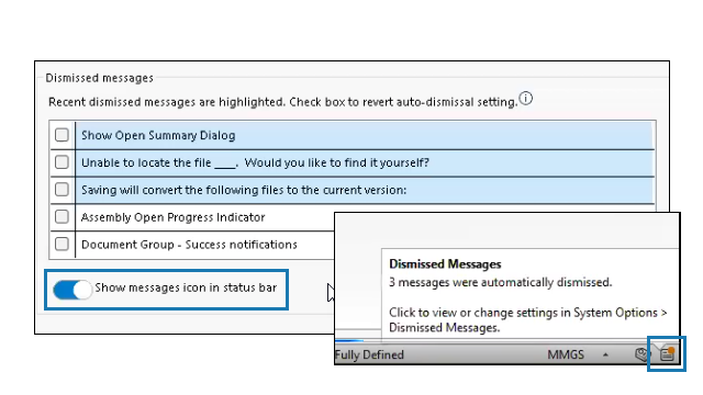

The status
bar in the SOLIDWORKS window
has a
Dismissed Messages icon that lets
you
quickly view the messages that you have dismissed earlier and
define
the settings to view those messages again.
Improvements:
- In
, click
You can turn on Show messages icon in status
bar to quickly access messages from the status bar.
- Hover over Dismissed
Messages
on the status
bar.
The
message box displays
the
number
of recently dismissed messages. Click the icon to access the Dismissed Messages page.
