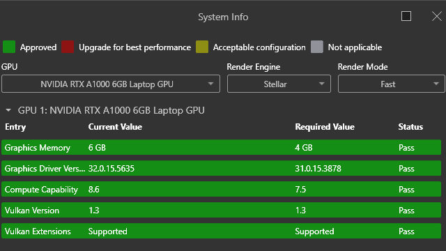

Different render engines and render modes require different minimum requirements and GPU compatibility. Therefore, the System Info dialog box is redesigned to reflect the support for additional hardware.
To access the System Info dialog box:
  1. Click Help > System Info.
  2. In the dialog box, specify the GPU, Render Engine, and Render Mode.
    The dialog box displays a system capability assessment. It also displays support for Vulkan Extensions if you selected the Stellar and Fast or the ProRender and Accurate combinations.
