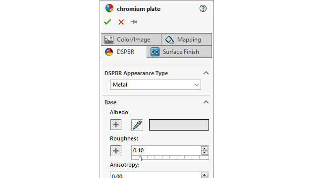

SOLIDWORKS 2026 supports DSPBR appearances, creating a seamless transition when you open designs in SOLIDWORKS Visualize to produce high-quality, photo-realistic images.
In the Appearances PropertyManager, a DSPBR tab ensures direct material-to-material translation. All parameters from SOLIDWORKS map directly to Visualize. To use the tab, select DSPBR (Dassault Systèmes Physically Based Rendering) under Appearance Visual Style in Tools > Options > System Options > Display.
Previously, Visualize approximated DSPBR materials when you opened a SOLIDWORKS file in Visualize. Visualize uses the same approximation when you open files created in SOLIDWORKS 2025 or earlier. For SOLIDWORKS 2026 files, the mapping of SOLIDWORKS DSPBR appearances to Visualize uses a 1:1 correlation, eliminating the potential of error-prone approximations and providing a unified experience.
You can still use these approximations if you:
  • In SOLIDWORKS Visualize, open a file created in SOLIDWORKS 2025 or earlier.
  • In SOLIDWORKS, click Tools > Options > System Options > Display. Under Appearance Visual Style, select Legacy Appearances.
