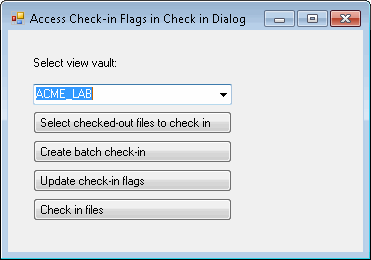

Access Check-in Flags in Check in Dialog Example (C#)
This example shows how to access the check-in flags in the SOLIDWORKS PDM Professional Check in dialog.
NOTE: If using the primary interop assembly provided with SOLIDWORKS PDM Professional, see Using .NET Framework 4.0 in Stand-alone Applications.
// Preconditions:
//  1. Start Microsoft Visual Studio.
//     a. Click File > New > Project > C#, Windows, Desktop > Windows Forms Application.
//     b. Type RefItemContainerCSharp in Project name.
//     c. For Location, click ... and navigate to the folder where to
create the project.
//     d. Click Next.
//     e. Select Framework.
//     f. Click Create.
//    g. Click Show All Files in the Solution Explorer toolbar and expand
//       Form1.cs in the Solution Explorer.
//     h. Replace the code in Form1.cs with this code. //     i. To create the form, replace the code in Form1.Designer.cs with  //        this code. //     j. To create the class for the callback: //        1. Right-click RefItemContainerCSharp in the Solution Explorer. //        2. Click Add > Class. //        3. Type Callback.cs in Name and click Add. //        4. Replace the code in Callback.cs with this code. //  2. Add dependencies and safely pass arrays of structures. //  3. Click Debug > Start Debugging or press F5. // // Postconditions:  //  1. Displays the Access Check-in Flags in Check in Dialog dialog box. //  2. Select a vault view. // 3. Click Select checked-out files to check in. // a. Displays the Select files dialog box. // b. Click one or more checked-out files to check in. // c. Click Open. //  4. Click Create batch check-in //     a. At the end of an attempted check-in, displays three message  //        boxes containing ProgressEnd called. Three operations occur for an  //        attempted check-in. //     b. Click OK to close each message box. //     c. Displays either: //        * Message box containing Batch check-in created. Click OK to  //          close the message box. //          - or - //        * Message box containing You did not select a file to check in. Please try  //          again. Click OK to close the message box, and repeat steps 3 and 4. //  5. Click Update check-in flags. //  6. Click OK to close the message box. //  7. Click Check in files. //  8. Displays the Check in dialog box. //  9. Click Check in to check in the files or Cancel to cancel the check in. // 10. Displays a message box containing ProgressEnd called. Click OK to close //     the message box. // 11. Examine the files in the vault to verify their checked-in or checked-out status. // 12. Close the Access Check-in Flags in Check in Dialog dialog box. //-------------------------------------------------------------------------------------- //Form1.cs using System; using System.Windows.Forms; using EPDM.Interop.epdm; namespace RefItemContainerCSharp {     public partial class Form1 : Form     {         public Form1()         {             InitializeComponent();         }         IEdmVault5 vault1 = null;         IEdmVault8 vault = null;         EdmSelItem[] selFiles = null;         IEdmBatchUnlock bUnlock = null;         void Form1_Load(System.Object sender, System.EventArgs e)         {             try             {                 vault1 = new EdmVault5();                 vault = (IEdmVault8)vault1;                 EdmViewInfo[] Views = { };                 vault.GetVaultViews(out Views, false);                 VaultsComboBox.Items.Clear();                 foreach (EdmViewInfo View in Views)                 {                     VaultsComboBox.Items.Add(View.mbsVaultName);                 }                 if (VaultsComboBox.Items.Count > 0)                 {                     VaultsComboBox.Text = (string)VaultsComboBox.Items[0];                 }               }             catch (System.Runtime.InteropServices.COMException ex)             {                 MessageBox.Show("HRESULT = 0x" + ex.ErrorCode.ToString("X") + " " + ex.Message);             }             catch (Exception ex)             {                 MessageBox.Show(ex.Message);             }         }         private void BrowseButton_Click(object sender, EventArgs e)         {             try             {                 //Only create a new vault object                 //if one hasn't been created yet                 if (vault1 == null)                 {                     vault1 = new EdmVault5();                 }                   if (!vault1.IsLoggedIn)                 {                     //Log into selected vault as the current user                     vault1.LoginAuto(VaultsComboBox.Text, this.Handle.ToInt32());                 }                  //Display the Select file dialog for user to                 //select the files                  EdmStrLst5 pathList = default(EdmStrLst5);                 pathList = vault.BrowseForFile(this.Handle.ToInt32(),  (int)EdmBrowseFlag.EdmBws_ForOpen + (int)EdmBrowseFlag.EdmBws_PermitMultipleSel +  (int)EdmBrowseFlag.EdmBws_PermitVaultFiles, "SOLIDWORKS files " +  "(*.sldprt; *.sldasm; *.slddrw)|" + "*.sldprt;*.sldasm;*.slddrw|" + "All Files (*.*)|*.*||""" "", vault.RootFolderPath"Select files");                 //Exit if the user clicks Cancel                 if (pathList == null)                     return;                 //Traverse the selected files                 IEdmPos5 pos = default(IEdmPos5);                 pos = pathList.GetHeadPosition();                 //Convert the selected files to an                 //array of EdmSelItem structs                 int nbrFiles = 0;                 nbrFiles = pathList.Count;                 Array.Resize(ref selFiles, nbrFiles);                 int i = 0;                 while (!pos.IsNull)                 {                     //Get each file path from the selected files list                     string filePath = null;                     IEdmFile5 file = default(IEdmFile5);                     IEdmFolder5 retFolder = default(IEdmFolder5);                     filePath = pathList.GetNext(pos);                     file = vault.GetFileFromPath(filePath, out retFolder);                     selFiles[i].mlDocID = file.ID;                     selFiles[i].mlProjID = retFolder.ID;                     i = i + 1;                 }                          }catch (System.Runtime.InteropServices.COMException ex)             {                 MessageBox.Show("HRESULT = 0x" + ex.ErrorCode.ToString("X") + "\n" + ex.Message);             }             catch (Exception ex)             {                 MessageBox.Show(ex.Message);             }         }         private void CreateBatchCheckinButton_Click(object sender, EventArgs e)         {             try             {                 //Only create a new vault object                 //if one hasn't been created yet                 if (vault1 == null)                 {                     vault1 = new EdmVault5();                 }                   if (!vault1.IsLoggedIn)                 {                     //Log into selected vault as the current user                     vault1.LoginAuto(VaultsComboBox.Text, this.Handle.ToInt32());                 }                 IEdmVault7 vault2 = (IEdmVault7)vault1;                 bUnlock = (IEdmBatchUnlock)vault2.CreateUtility(EdmUtility.EdmUtil_BatchUnlock);                 bUnlock.AddSelection((EdmVault5)vault1, ref selFiles);                 bool tree = false; Callback myCallback = new Callback();                 tree = bUnlock.CreateTree(this.Handle.ToInt32(), (int)EdmUnlockBuildTreeFlags.Eubtf_MayUnlock, myCallback);                 if (tree == false)                 {                      MessageBox.Show("You did not select a file to check in. Please try again.");                     return;                 }                 MessageBox.Show("Batch check in created.");             }             catch (System.Runtime.InteropServices.COMException ex)             {                 MessageBox.Show("HRESULT = 0x" + ex.ErrorCode.ToString("X") + "\n" + ex.Message);             }             catch (Exception ex)             {                 MessageBox.Show(ex.Message);             }         }         private void UpdateBatchCheckInButton_Click(object sender, EventArgs e)         {              try             {                 //Only create a new vault object                 //if one hasn't been created yet                 if (vault1 == null)                 {                     vault1 = new EdmVault5();                 }                   if (!vault1.IsLoggedIn)                 {                     //Log into selected vault as the current user                     vault1.LoginAuto(VaultsComboBox.Text, this.Handle.ToInt32());                 }                     IEdmRefItemContainer container = null;                     container = (IEdmRefItemContainer)bUnlock;                     object[] items = null;                     IEdmRefItem theItem = null;                     container.GetItems(EdmRefItemType.Edmrit_All, out items);                     int j = 0;                     while (j < items.Length)                     {                         IEdmRefItem aItem = null;                         theItem = (IEdmRefItem)items[j];                         aItem = theItem;                         object value = null;                         aItem.SetProperty(EdmRefItemProperty.Edmrip_CheckKeepLocked, value);                         j = j + 1;                     }                     MessageBox.Show("Check-in flags updated.");              }                              catch (System.Runtime.InteropServices.COMException ex)             {                 MessageBox.Show("HRESULT = 0x" + ex.ErrorCode.ToString("X") + "\n" + ex.Message);             }             catch (Exception ex)             {                 MessageBox.Show(ex.Message);             }         }         private void CheckInButton_Click(object sender, EventArgs e)         {             try             {                 //Only create a new vault object                 //if one hasn't been created yet                 if (vault1 == null)                 {                     vault1 = new EdmVault5();                 }                   if (!vault1.IsLoggedIn)                 {                     //Log into selected vault as the current user                     vault1.LoginAuto(VaultsComboBox.Text, this.Handle.ToInt32());                 }                 if (bUnlock.ShowDlg(this.Handle.ToInt32()))                 {                     Callback myCallback = new Callback();                     bUnlock.UnlockFiles(this.Handle.ToInt32(), myCallback);                 }             }             catch (System.Runtime.InteropServices.COMException ex)             {                 MessageBox.Show("HRESULT = 0x" + ex.ErrorCode.ToString("X") + "\n" + ex.Message);             }             catch (Exception ex)             {                 MessageBox.Show(ex.Message);             }         }      } }

            this.Text = "Access Check-in Flags in Check in Dialog";
