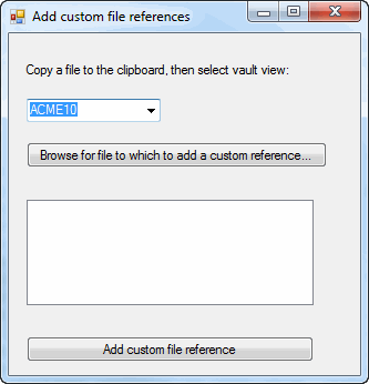

Add Custom File Reference Example (VB.NET)
This example shows how to add a custom file reference to a file in the vault.
NOTE: If using the primary interop assembly provided with SOLIDWORKS PDM Professional, see Using .NET Framework 4.0 in Stand-alone Applications.
' Preconditions:
' 1. Start Microsoft Visual Studio.
'    a. Click File > New > Project > Visual Basic, Windows, Desktop > Windows Forms Application.
'    b. Type CustRef in Project name.
'    c. For Location, click ... and navigate to the folder where to create the project.
'      d. Click Next.
'    e. Select Framework.
'    f. Click Create
'    g. Click Show All Files in the Solution Explorer toolbar and expand
'        Form1.vb in the Solution Explorer.
'    h. Replace the code in Form1.vb with this code.
'    i. Replace the code in Form1.Designer.vb with this code.
' 2. Add dependencies and safely pass arrays of structures.
' 3. Click Debug > Start Debugging or press F5.
' Postconditions:
' 1. The Add custom references dialog displays.
' 2. Select a vault.
' 3. Click Browse for file to which to add custom reference
'    locate and click a file in the vault, and click Open.
'    The file is checked out.
' 4. In a view of the selected vault, right-click a file and click Copy.
' 5. In the Add custom references dialog, click Add custom file reference.
'    The file that was copied to the clipboard is added as a custom
'    reference to the checked-out file.
' 6. In the Create File References dialog, click OK.
'    The file is checked in.
' 7. In the Edit User-Defined File References dialog, click OK.
' 8. Close the Add custom references dialog.

'Form1.Designer.vb

        Me.VaultsLabel = New System.Windows.Forms.Label()
        Me.VaultsComboBox = New System.Windows.Forms.ComboBox()
        Me.BrowseButton = New System.Windows.Forms.Button()
        Me.CustRefListBox = New System.Windows.Forms.ListBox()
        Me.AddCustomFileReference = New System.Windows.Forms.Button()
        Me.CustRefOpenFileDialog = New System.Windows.Forms.OpenFileDialog()
        Me.SuspendLayout()
        'VaultsLabel
        Me.VaultsLabel.AutoSize = True
        Me.VaultsLabel.Location = New System.Drawing.Point(13, 26)
        Me.VaultsLabel.Name = "VaultsLabel"
        Me.VaultsLabel.Size = New System.Drawing.Size(244, 13)
        Me.VaultsLabel.TabIndex = 0
        Me.VaultsLabel.Text = "Copy a file to the clipboard, then select vault view:"
        'VaultsComboBox
        Me.VaultsComboBox.FormattingEnabled = True
        Me.VaultsComboBox.Location = New System.Drawing.Point(16, 59)
        Me.VaultsComboBox.Name = "VaultsComboBox"
        Me.VaultsComboBox.Size = New System.Drawing.Size(121, 21)
        Me.VaultsComboBox.TabIndex = 1
        'BrowseButton
        Me.BrowseButton.Location = New System.Drawing.Point(16, 98)
        Me.BrowseButton.Name = "BrowseButton"
        Me.BrowseButton.Size = New System.Drawing.Size(271, 23)
        Me.BrowseButton.TabIndex = 3
        Me.BrowseButton.Text = "Browse for file to which to add a custom reference..."
        Me.BrowseButton.UseVisualStyleBackColor = True
        'CustRefListBox
        Me.CustRefListBox.FormattingEnabled = True
        Me.CustRefListBox.Location = New System.Drawing.Point(16, 150)
        Me.CustRefListBox.Name = "CustRefListBox"
        Me.CustRefListBox.Size = New System.Drawing.Size(259, 95)
        Me.CustRefListBox.TabIndex = 4
        'AddCustomFileReference
        Me.AddCustomFileReference.Location = New System.Drawing.Point(16, 273)
        Me.AddCustomFileReference.Name = "AddCustomFileReference"
        Me.AddCustomFileReference.Size = New System.Drawing.Size(259, 23)
        Me.AddCustomFileReference.TabIndex = 5
        Me.AddCustomFileReference.Text = "Add custom file reference"
        Me.AddCustomFileReference.UseVisualStyleBackColor = True
        'Form1
        Me.AutoScaleDimensions = New System.Drawing.SizeF(6.0!, 13.0!)
        Me.AutoScaleMode = System.Windows.Forms.AutoScaleMode.Font
        Me.ClientSize = New System.Drawing.Size(317, 308)
        Me.Controls.Add(Me.AddCustomFileReference)
        Me.Controls.Add(Me.CustRefListBox)
        Me.Controls.Add(Me.BrowseButton)
        Me.Controls.Add(Me.VaultsComboBox)
        Me.Controls.Add(Me.VaultsLabel)
        Me.Name = "Form1"
        Me.Text = "Add custom file references"
        Me.ResumeLayout(False)
        Me.PerformLayout()
