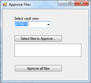

' 1. The Approve Files dialog box displays.
'    a. Select a vault view.
'    b. Click Select files to approve.
'    c. In the Select File dialog:
'       1. Select vault files in the Waiting for Approval state.
'       2. Click Open.
'    d. Click Approve all files.
' 2. Click OK in the Do Transition dialog box.
'    The selected files change to the Approved state using the Passed Approval
'    transition.
' 3. Close the Approve Files dialog box.

        Me.VaultsLabel = New System.Windows.Forms.Label()
        Me.VaultsComboBox = New System.Windows.Forms.ComboBox()
        Me.Transition = New System.Windows.Forms.Button()
        Me.File1List = New System.Windows.Forms.ListBox()
        Me.BatchChange = New System.Windows.Forms.Button()
        Me.OpenFileDialog1 = New System.Windows.Forms.OpenFileDialog()
        Me.SuspendLayout()
        'VaultsLabel
        Me.VaultsLabel.AutoSize = True
        Me.VaultsLabel.Location = New System.Drawing.Point(36, 24)
        Me.VaultsLabel.Name = "VaultsLabel"
        Me.VaultsLabel.Size = New System.Drawing.Size(91, 13)
        Me.VaultsLabel.TabIndex = 0
        Me.VaultsLabel.Text = "Select vault view:"
        'VaultsComboBox
        Me.VaultsComboBox.FormattingEnabled = True
        Me.VaultsComboBox.Location = New System.Drawing.Point(39, 40)
        Me.VaultsComboBox.Name = "VaultsComboBox"
        Me.VaultsComboBox.Size = New System.Drawing.Size(121, 21)
        Me.VaultsComboBox.TabIndex = 1
        'Transition
        Me.Transition.Location = New System.Drawing.Point(39, 85)
        Me.Transition.Name = "Transition"
        Me.Transition.Size = New System.Drawing.Size(158, 23)
        Me.Transition.TabIndex = 2
        Me.Transition.Text = "Select files to approve..."
        Me.Transition.UseVisualStyleBackColor = True
        'File1List
        Me.File1List.FormattingEnabled = True
        Me.File1List.HorizontalScrollbar = True
        Me.File1List.Location = New System.Drawing.Point(40, 114)
        Me.File1List.Name = "File1List"
        Me.File1List.SelectionMode = System.Windows.Forms.SelectionMode.MultiExtended
        Me.File1List.Size = New System.Drawing.Size(220, 43)
        Me.File1List.TabIndex = 4
        'BatchChange
        Me.BatchChange.Location = New System.Drawing.Point(40, 183)
        Me.BatchChange.Name = "BatchChange"
        Me.BatchChange.Size = New System.Drawing.Size(157, 23)
        Me.BatchChange.TabIndex = 6
        Me.BatchChange.Text = "Approve all files"
        Me.BatchChange.UseVisualStyleBackColor = True
        'OpenFileDialog1
        Me.OpenFileDialog1.FileName = "OpenFileDialog1"
        Me.OpenFileDialog1.Multiselect = True
        Me.OpenFileDialog1.Title = "Select File"
        'Form1
        Me.AutoScaleDimensions = New System.Drawing.SizeF(6.0!, 13.0!)
        Me.AutoScaleMode = System.Windows.Forms.AutoScaleMode.Font
        Me.ClientSize = New System.Drawing.Size(284, 235)
        Me.Controls.Add(Me.BatchChange)
        Me.Controls.Add(Me.File1List)
        Me.Controls.Add(Me.Transition)
        Me.Controls.Add(Me.VaultsComboBox)
        Me.Controls.Add(Me.VaultsLabel)
        Me.Name = "Form1"
        Me.Text = "Approve Files"
        Me.ResumeLayout(False)
