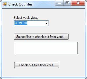

Batch Check Out Files Example (C#)
This example shows how to check out several files from the vault in one batch.
NOTE: If using the primary interop assembly provided with SOLIDWORKS PDM Professional, see Using .NET Framework 4.0 in Stand-alone Applications.
// Preconditions:
// 1. Start Microsoft Visual Studio.
//    a. Click File > New > Project > C#, Windows, Desktop > Windows Forms Application.
//    b. Type BatchGetFiles_CSharp in Project name.
//    c. For Location, click ... and navigate to the folder where to create the project.
//    d. Click Next.
//    e. Select Framework.
//    f. Click Create.
//    g. Click Show All Files in the Solution Explorer toolbar and expand
//       Form1.cs in the Solution Explorer.
//    h. Replace the code in Form1.cs with this code.
//    i. To create the form, replace the code in Form1.Designer.cs with
//       this code.
// 2. Add dependencies and safely pass arrays of structures.
// 3. Ensure that the vault contains at least one checked-in file.
// 4. Click Debug > Start Debugging or press F5.
// Postconditions:
//  1. The Check Out Files dialog box displays.
//     a. Select a vault view.
//     b. Click Select files to check out from vault.
//     c. In the Select File dialog:
//        1. Click a couple of files inside the vault.
//        2. Click Open.
//     d. Click Check out files from vault.
//  2. Click Check Out in the Check Out dialog box.
//  3. Close the Check Out Files dialog box.
//  4. Observe that the selected files are checked out of the selected vault.

        private void InitializeComponent()
            this.VaultsLabel = new System.Windows.Forms.Label();
            this.VaultsComboBox = new System.Windows.Forms.ComboBox();
            this.SelectFiles = new System.Windows.Forms.Button();
            this.File1List = new System.Windows.Forms.ListBox();
            this.BatchGet = new System.Windows.Forms.Button();
            this.OpenFileDialog1 = new System.Windows.Forms.OpenFileDialog();
            this.SuspendLayout();
            //VaultsLabel
            this.VaultsLabel.AutoSize = true;
            this.VaultsLabel.Location = new System.Drawing.Point(36, 24);
            this.VaultsLabel.Name = "VaultsLabel";
            this.VaultsLabel.Size = new System.Drawing.Size(91, 13);
            this.VaultsLabel.TabIndex = 0;
            this.VaultsLabel.Text = "Select vault view:";
            //VaultsComboBox
            this.VaultsComboBox.FormattingEnabled = true;
            this.VaultsComboBox.Location = new System.Drawing.Point(39, 40);
            this.VaultsComboBox.Name = "VaultsComboBox";
            this.VaultsComboBox.Size = new System.Drawing.Size(121, 21);
            this.VaultsComboBox.TabIndex = 1;
            //SelectFiles
            this.SelectFiles.Location = new System.Drawing.Point(39, 85);
            this.SelectFiles.Name = "SelectFiles";
            this.SelectFiles.Size = new System.Drawing.Size(191, 23);
            this.SelectFiles.TabIndex = 2;
            this.SelectFiles.Text = "Select files to check out from vault...";
            this.SelectFiles.UseVisualStyleBackColor = true;
            this.SelectFiles.Click += new System.EventHandler(SelectFiles_Click);
            //File1List
            this.File1List.FormattingEnabled = true;
            this.File1List.HorizontalScrollbar = true;
            this.File1List.Location = new System.Drawing.Point(40, 114);
            this.File1List.Name = "File1List";
            this.File1List.SelectionMode = System.Windows.Forms.SelectionMode.MultiExtended;
            this.File1List.Size = new System.Drawing.Size(220, 43);
            this.File1List.TabIndex = 4;
            //BatchGet
            this.BatchGet.Location = new System.Drawing.Point(40, 183);
            this.BatchGet.Name = "BatchGet";
            this.BatchGet.Size = new System.Drawing.Size(157, 23);
            this.BatchGet.TabIndex = 6;
            this.BatchGet.Text = "Check out files from vault";
            this.BatchGet.UseVisualStyleBackColor = true;
            this.BatchGet.Click += new System.EventHandler(this.BatchGet_Click);
            //OpenFileDialog1
            this.OpenFileDialog1.FileName = "OpenFileDialog1";
            this.OpenFileDialog1.Multiselect = true;
            this.OpenFileDialog1.Title = "Select File";
            //Form1
            this.AutoScaleDimensions = new System.Drawing.SizeF(6f, 13f);
            this.AutoScaleMode = System.Windows.Forms.AutoScaleMode.Font;
            this.ClientSize = new System.Drawing.Size(284, 235);
            this.Controls.Add(this.BatchGet);
            this.Controls.Add(this.File1List);
            this.Controls.Add(this.SelectFiles);
            this.Controls.Add(this.VaultsComboBox);
            this.Controls.Add(this.VaultsLabel);
            this.Name = "Form1";
            this.Text = "Check Out Files";
            this.Load += new System.EventHandler(this.Form1_Load);
            this.ResumeLayout(false);
            this.PerformLayout();
