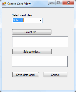

Create Card View Example (C#)
This example shows how to create a file or folder card view.
NOTE: If using the primary interop assembly provided with SOLIDWORKS PDM Professional, see Using .NET Framework 4.0 in Stand-alone Applications.
// Preconditions:
// 1. Start Microsoft Visual Studio.
//    a. Click File > New > Project > C#, Windows, Desktop > Windows Forms App.
//    b. Type CreateCardView_CSharp in Project name.
//    c. For Location, click ... and navigate to the folder where to create the project.
//    d. Click Next.
//    e. Select Framework.
//    f. Click Create.
//    g. Click Show All Files in the Solution Explorer toolbar and expand
//       Form1.cs in the Solution Explorer.
//    h. Replace the code in Form1.cs with this code.
//    i. To create the form, replace the code in Form1.Designer.cs with
//       this code.
// 2. Add dependencies and safely pass arrays of structures.
// 3. Create a folder in a vault.
// 4.
Check out a file from the vault in which you created the folder.
// 5. Click Debug > Start Debugging or press F5.
// Postconditions:
1. Displays the Create Card View dialog box.
// 2. Select the vault view in which you created a folder and
//    checked out a file.
// 3. Click either:
//    a. Select file.
//    b. In the Select File dialog:
//       1. Click the file checked out in Preconditions step 5.
//       2. Click Open.
//       3. Inspect the message box, then click OK.
//    c. In the file data card, modify a field.
//    d. Click Save data card.
//    e. Check in the file and inspect its data card.
//       - or -
//    a. Select folder.
//    b. In the Select Folder dialog, select the vault folder created
//       in Preconditions step 4 and click OK.
//    c. Inspect the message box, then click OK.
//    d. In the folder data card, click the Edit Values tab.
//    e. Modify a field.
//    f. Click Save data card.
//    g. Inspect the folder card in the vault.
// 4. Close the Create Card View dialog box.
