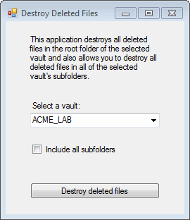

This example shows how to create an application that displays a form in which a user can select the vault in whose root folder and subfolders all deleted files will be permanently destroyed. The user must have permission to delete files.

// Preconditions:
//  1. Start Microsoft Visual Studio.
//  2. Click File > New > Project > C#, Windows, Desktop > Windows Forms App.
//  3. Type DestroyDeletedItems in Project name.
//  4. For Location, click ... and navigate to the folder where to create the project.
//  5. Click Next.
//  6. Select Framework.
//  7. Click Create.
//  8. Click Show All Files in the Solution Explorer toolbar and expand
//     Form1.cs in the Solution Explorer.
//  9. Replace the code in Form1.cs with this code.
// 10. Replace the code in Form1.Designer.cs with this code.
// 11. Add dependencies and safely pass arrays of structures.
// 12. Ensure that the namespaces specified in all of the *.cs files match
//     the project name.
// 13. Delete one or more checked-in files from the root folder of your vault.
// 14. Click Debug > Start Debugging or press F5.
// Postconditions:
//  1. Displays the Destroy Deleted Files dialog.
//  2. Select a vault.
//  3. Optionally select the Include all subfolders check box.
//  4. Click the Destroy deleted files button.
//     A message box pops up informing you that:
//     * No deleted files were found to destroy.
//       - or -
//     * The deleted files were destroyed.
//  5. Click OK in the message box.
//  6. Close the Destroy Deleted Files dialog.

            this.label1 = new System.Windows.Forms.Label();
            this.VaultsLabel = new System.Windows.Forms.Label();
            this.VaultsComboBox = new System.Windows.Forms.ComboBox();
            this.DestroyDeletedItemsButton = new System.Windows.Forms.Button();
            this.CheckBox_Recursive = new System.Windows.Forms.CheckBox();

            // label1
            this.label1.Location = new System.Drawing.Point(32, 19);
            this.label1.Name = "label1";
            this.label1.Size = new System.Drawing.Size(187, 79);
            this.label1.TabIndex = 0;
            this.label1.Text = "This application destroys all deleted files in the root folder of the selected va" +
            "ult and also allows you to destroy all deleted files in all of the selected vaul" +
            "t\'s subfolders.";
            this.label1.Click += new System.EventHandler(this.label1_Click);
            // VaultsLabel
            this.VaultsLabel.AutoSize = true;
            this.VaultsLabel.Location = new System.Drawing.Point(35, 113);
            this.VaultsLabel.Name = "VaultsLabel";
            this.VaultsLabel.Size = new System.Drawing.Size(75, 13);
            this.VaultsLabel.TabIndex = 1;
            this.VaultsLabel.Text = "Select a vault:";
            // VaultsComboBox
            this.VaultsComboBox.FormattingEnabled = true;
            this.VaultsComboBox.Location = new System.Drawing.Point(35, 130);
            this.VaultsComboBox.Name = "VaultsComboBox";
            this.VaultsComboBox.Size = new System.Drawing.Size(184, 21);
            this.VaultsComboBox.TabIndex = 2;
            // DestroyDeletedItemsButton
            this.DestroyDeletedItemsButton.Location = new System.Drawing.Point(35, 229);
            this.DestroyDeletedItemsButton.Name = "DestroyDeletedItemsButton";
            this.DestroyDeletedItemsButton.Size = new System.Drawing.Size(184, 23);
            this.DestroyDeletedItemsButton.TabIndex = 4;
            this.DestroyDeletedItemsButton.Text = "Destroy deleted files";
            this.DestroyDeletedItemsButton.UseVisualStyleBackColor = true;
            this.DestroyDeletedItemsButton.Click += new System.EventHandler(this.DestroyDeletedItemsButton_Click);
            // CheckBox_Recursive
            this.CheckBox_Recursive.AutoSize = true;
            this.CheckBox_Recursive.Location = new System.Drawing.Point(38, 174);
            this.CheckBox_Recursive.Name = "CheckBox_Recursive";
            this.CheckBox_Recursive.Size = new System.Drawing.Size(125, 17);
            this.CheckBox_Recursive.TabIndex = 5;
            this.CheckBox_Recursive.Text = "Include all subfolders";
            this.CheckBox_Recursive.UseVisualStyleBackColor = true;
            this.CheckBox_Recursive.CheckedChanged += new System.EventHandler(this.CheckBox_Recursive_CheckedChanged);
