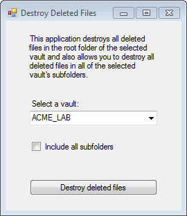

This example shows how to create an application that displays a form in which a user can select the vault in whose root folder and subfolders all deleted files will be permanently destroyed. The user must have permission to delete files.

'  1. Displays the Destroy Deleted Files dialog.
'  2. Select a vault.
'  3. Optionally select the Include all subfolders check box.
'  4. Click the Destroy deleted files button.

        Me.Label1.Text = "This application destroys all deleted files in the root folder of the selected va" & _
            "ult and also allows you to destroy all deleted files in all of the selected vaul" & _
            "t's subfolders."

        Me.VaultsLabel.Text = "Select a vault:"
