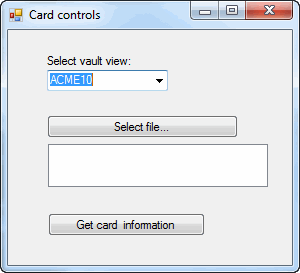

//12. Ensure that there is a file in the vault whose extension has a
//    file data card in the vault.
//13. Click Debug > Start Debugging or press F5.
// Postconditions:
//  1. Displays a dialog.
//  2. Select a vault.
//  3. Click Select file.
//  4. In the Select File dialog:
//     a. Click a file whose extension has a file data card in the vault.
//     b. Click Open.
//  5. Click Get card information.
//  6. A message box displays information about the selected file's data card.
//  7. Click OK in the message box.
//  8. A message box displays the list items of any drop list controls.
//  9. Click OK in the message box.
// 10. A message box displays information about each edit box control in the
//     data card.
// 11. Click OK in the message box.
// 12. Close the dialog.

            this.VaultsLabel = new System.Windows.Forms.Label();
            this.VaultsComboBox = new System.Windows.Forms.ComboBox();
            this.SelectFiles = new System.Windows.Forms.Button();
            this.File1List = new System.Windows.Forms.ListBox();
            this.GetCardControls = new System.Windows.Forms.Button();
            this.OpenFileDialog1 = new System.Windows.Forms.OpenFileDialog();
            this.SuspendLayout();
            //VaultsLabel
            this.VaultsLabel.AutoSize = true;
            this.VaultsLabel.Location = new System.Drawing.Point(36, 24);
            this.VaultsLabel.Name = "VaultsLabel";
            this.VaultsLabel.Size = new System.Drawing.Size(91, 13);
            this.VaultsLabel.TabIndex = 0;
            this.VaultsLabel.Text = "Select vault view:";
            //VaultsComboBox
            this.VaultsComboBox.FormattingEnabled = true;
            this.VaultsComboBox.Location = new System.Drawing.Point(39, 40);
            this.VaultsComboBox.Name = "VaultsComboBox";
            this.VaultsComboBox.Size = new System.Drawing.Size(121, 21);
            this.VaultsComboBox.TabIndex = 1;
            //SelectFiles
            this.SelectFiles.Location = new System.Drawing.Point(39, 85);
            this.SelectFiles.Name = "SelectFiles";
            this.SelectFiles.Size = new System.Drawing.Size(191, 23);
            this.SelectFiles.TabIndex = 2;
            this.SelectFiles.Text = "Select file...";
            this.SelectFiles.UseVisualStyleBackColor = true;
            this.SelectFiles.Click +=new System.EventHandler(SelectFiles_Click);
            //File1List
            this.File1List.FormattingEnabled = true;
            this.File1List.HorizontalScrollbar = true;
            this.File1List.Location = new System.Drawing.Point(40, 114);
            this.File1List.Name = "File1List";
            this.File1List.SelectionMode = System.Windows.Forms.SelectionMode.MultiExtended;
            this.File1List.Size = new System.Drawing.Size(220, 43);
            this.File1List.TabIndex = 4;
            //GetCardControls
            this.GetCardControls.Location = new System.Drawing.Point(40, 183);
            this.GetCardControls.Name = "GetCardControls";
            this.GetCardControls.Size = new System.Drawing.Size(157, 23);
            this.GetCardControls.TabIndex = 6;
            this.GetCardControls.Text = "Get card  information";
            this.GetCardControls.UseVisualStyleBackColor = true;
            this.GetCardControls.Click += new System.EventHandler(GetCardControls_Click);
            //OpenFileDialog1
            this.OpenFileDialog1.FileName = "OpenFileDialog1";
            this.OpenFileDialog1.Title = "Select File";
            //Form1
            this.AutoScaleDimensions = new System.Drawing.SizeF(6f, 13f);
            this.AutoScaleMode = System.Windows.Forms.AutoScaleMode.Font;
            this.ClientSize = new System.Drawing.Size(284, 235);
            this.Controls.Add(this.GetCardControls);
            this.Controls.Add(this.File1List);
            this.Controls.Add(this.SelectFiles);
            this.Controls.Add(this.VaultsComboBox);
            this.Controls.Add(this.VaultsLabel);
            this.Name = "Form1";
            this.Text = "Card controls";
            this.Load += new System.EventHandler(this.Form1_Load);
            this.ResumeLayout(false);
            this.PerformLayout();
        internal System.Windows.Forms.Label VaultsLabel;
        internal System.Windows.Forms.ComboBox VaultsComboBox;
        internal System.Windows.Forms.Button SelectFiles;
        internal System.Windows.Forms.ListBox File1List;
        internal System.Windows.Forms.Button GetCardControls;
        internal System.Windows.Forms.OpenFileDialog OpenFileDialog1;
