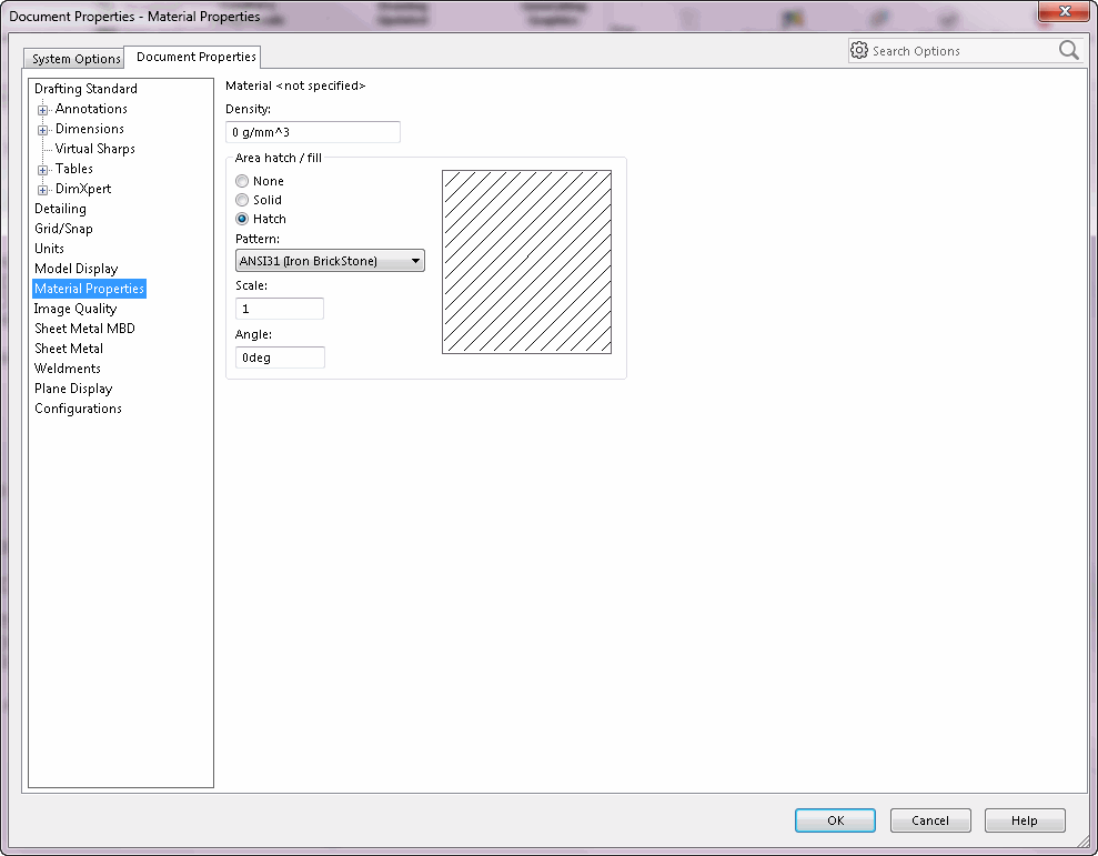

Document Properties > Material Properties
Setting
Get/Set Methods
Return Value or <Value>
Comments
Density
IModelDocExtension::GetUserPreferenceDouble(swUserPreferenceDoubleValue_e.swMaterialPropertyDensity, swUserPreferenceOption_e.swDetailingNoOptionSpecified)
IModelDocExtension::SetUserPreferenceDouble(swUserPreferenceDoubleValue_e.swMaterialPropertyDensity, swUserPreferenceOption_e.swDetailingNoOptionSpecified, <Value>)
Double value in kg/m^3
For parts only; specifies material density
Area Hatch/Fill - Style
IModelDocExtension::GetUserPreferenceInteger(swUserPreferenceIntegerValue_e.swMaterialPropertyAreaHatchFillStyle, swUserPreferenceOption_e.swDetailingNoOptionSpecified)
IModelDocExtension::SetUserPreferenceInteger(swUserPreferenceIntegerValue_e.swMaterialPropertyAreaHatchFillStyle, swUserPreferenceOption_e.swDetailingNoOptionSpecified, swAreaHatchFillStyle_e.<Value>)
See swAreaHatchFillStyle_e for valid options
Area Hatch/Fill - Pattern
IModelDocExtension::GetUserPreferenceString(swUserPreferenceStringValue_e.swMaterialPropertyCrosshatchPattern, swuserPreferenceOption_e.swDetailingNoOptionSpecified)
IModelDocExtension::SetUserPreferenceString(swUserPreferenceStringValue_e.swMaterialPropertyCrosshatchPattern, swuserPreferenceOption_e.swDetailingNoOptionSpecified, <Value>)
Valid string values:
For parts only; for hatch style only
Area Hatch/Fill - Scale
IModelDocExtension::GetUserPreferenceDouble(swUserPreferenceDoubleValue_e.swMaterialPropertyCrosshatchScale, swUserPreferenceOption_e.swDetailingNoOptionSpecified)
IModelDocExtension::SetUserPreferenceDouble(swUserPreferenceDoubleValue_e.swMaterialPropertyCrosshatchScale, swUserPreferenceOption_e.swDetailingNoOptionSpecified, <Value>)
Double value
For parts only; for hatch style only; specifies value by which to scale crosshatch
Area Hatch/Fill - Angle
IModelDocExtension::GetUserPreferenceDouble(swUserPreferenceDoubleValue_e.swMaterialPropertyCrosshatchAngle, swUserPreferenceOption_e.swDetailingNoOptionSpecified)
IModelDocExtension::SetUserPreferenceDouble(swUserPreferenceDoubleValue_e.swMaterialPropertyCrosshatchAngle, swUserPreferenceOption_e.swDetailingNoOptionSpecified, <Value>)
Double value
For parts only; for hatch style only; specifies angle for crosshatch
