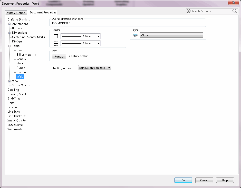

Document Properties > Tables > Weld
NOTE: Setting any of the following weld table values means that new weld tables added to the drawing use these default values. However, a weld table that uses a template table for insertion might not use these default values because the template table contains certain properties that take precedence over these default values.
Setting
Get/Set Methods
Return Value or <Value>
Comments
Border - Box Border
IModelDocExtension::GetUserPreferenceInteger(swUserPreferenceIntegerValue_e.swDetailingWeldTableBorderLineWeight, swUserPreferenceOption_e.swDetailingNoOptionSpecified)
IModelDocExtension::SetUserPreferenceInteger(swUserPreferenceIntegerValue_e.swDetailingWeldTableBorderLineWeight, swUserPreferenceOption_e.swDetailingNoOptionSpecified, swLineWeights_e.<Value>)
See swLineWeights_e for valid options
Border - Grid Border
ModelDocExtension::GetUserPreferenceInteger(swUserPreferenceIntegerValue_e.swDetailingWeldTableGridLineWeight, swUserPreferenceOption_e.swDetailingNoOptionSpecified)
IModelDocExtension::SetUserPreferenceInteger(swUserPreferenceIntegerValue_e.swDetailingWeldTableGridLineWeight, swUserPreferenceOption_e.swDetailingNoOptionSpecified, swLineWeights_e.<Value>)
Text - Font...
IModelDocExtension::GetUserPreferenceTextFormat(swUserPreferenceTextFormat_e.swDetailingWeldSymbolTextFormat, swUserPreferenceOption_e.swDetailingNoOptionSpecified)
IModelDocExtension::SetUserPreferenceTextFormat(swUserPreferenceTextFormat_e.swDetailingWeldSymbolTextFormat, swUserPreferenceOption_e.swDetailingNoOptionSpecified, <Value>)
See ITextFormat for font options
To set font property values, implement ITextFormat, set the appropriate ITextFormat member values, and pass the ITextFormat object in the set method
Trailing zeroes
IModelDocExtension::GetUserPreferenceInteger(swUserPreferenceIntegerValue_e.swDetailingDimTrailingZero, swUserPreferenceOption_e.swDetailingWeldTable)
IModelDocExtension::SetUserPreferenceInteger(swUserPreferenceIntegerValue_e.swDetailingDimTrailingZero, swUserPreferenceOption_e.swDetailingWeldTable, swDetailingDimTrailingZero_e.<Value>)
Valid options in swDetailingDimTrailingZero_e:
  • swDimShowTrailingZeroes
  • swDimRemoveTrailingZeroes
  • swDimRemoveOnlyOnZero
  • swDimSameAsSource
Layer
IModelDocExtension::GetUserPreferenceString(swUserPreferenceStringValue_e.swDetailingLayer, swUserPreferenceOption_e.swDetailingWeldTable)
IModelDocExtension::SetUserPreferenceString(swUserPreferenceStringValue_e.swDetailingLayer, swUserPreferenceOption_e.swDetailingWeldTable, <Value>)
Valid options:
  • "Border"
  • "Dimensions"
  • "Notes"
  • "BOM"
  • "FORMAT"
  • "None"
This setting is available only on drawings; depending on drawing, some options may not apply
