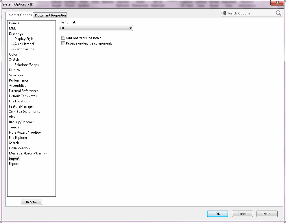

System Options > Import > IDF
To display the dialog:
Click Tools > Options > System Options > Import > IDF in File Format.
- or -
  1. Click File > Open.
  2. In Files of type, select IDF.
  3. Click Options.

Add board drilled holes
ISldWorks::GetUserPreferenceToggle(swUserPreferenceToggle_e.swImportIDFAddDrilledHoles)
ISldWorks::SetUserPreferenceToggle(swUserPreferenceToggle_e.swImportIDFAddDrilledHoles. <OnFlag>)
Boolean value
Specifies whether to add drilled holes from the circuit board; for Intermediate Data Format (IDF) circuit boards files only
Reverse underside components
ISldWorks::GetUserPreferenceToggle(swUserPreferenceToggle_e.swImportIDFReverseUndersideComponents)
ISldWorks::SetUserPreferenceToggle(swUserPreferenceToggle_e.swImportIDFReverseUndersideComponents. <OnFlag>)
Boolean value
Specifies whether to compensate for incorrectly rotated components by allowing proper location of the component features; for Intermediate Data Format (IDF) circuit board files only
