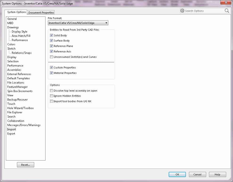

System Options > Import > Inventor/Catia V5/Creo/NX/Solid Edge
To display the dialog:
Select Tools > Options > System Options > Import > File Format > Inventor/Catia V5/Creo/NX/Solid Edge.
- or -
  1. Click File > Open.
  2. In Files of type, select Inventor (Part or Assembly), Catia V5, ProE/Creo (Part or Assembly), Unigraphics/NX, or Solid Edge (Part or Assembly).
  3. Click Options.
Setting
Get/Set Methods
Return Value
or
<Value>
or
<OnFlag>
Comment
Entities to Read From 3rd Party CAD Files - Solid Body
ISldWorks::GetUserPreferenceToggle(swUserPreferenceToggle_e.swImportSolidBody)
ISldWorks::SetUserPreferenceToggle(swUserPreferenceToggle_e.swImportSolidBody, <OnFlag>)
Boolean value
Entities to Read From 3rd Party CAD Files - Surface Body
ISldWorks::GetUserPreferenceToggle(swUserPreferenceToggle_e.swImportSurfaceBody)
ISldWorks::SetUserPreferenceToggle(swUserPreferenceToggle_e.swImportSurfaceBody, <OnFlag>)
Boolean value
Entities to Read From 3rd Party CAD Files - Reference Plane
ISldWorks::GetUserPreferenceToggle(swUserPreferenceToggle_e.swImportReferencePlane)
ISldWorks::SetUserPreferenceToggle(swUserPreferenceToggle_e.swImportReferencePlane, <OnFlag>)
Boolean value
Entities to Read From 3rd Party CAD Files - Reference Axis
ISldWorks::GetUserPreferenceToggle(swUserPreferenceToggle_e.swImportReferenceAxis)
ISldWorks::SetUserPreferenceToggle(swUserPreferenceToggle_e.swImportReferenceAxis, <OnFlag>)
Boolean value
Entities to Read From 3rd Party CAD Files - Unconsumed Sketch(es) and Curves
ISldWorks::GetUserPreferenceToggle(swUserPreferenceToggle_e.swImportUnconsumedSketchesAndCurves)
ISldWorks::SetUserPreferenceToggle(swUserPreferenceToggle_e.swImportUnconsumedSketchesAndCurves, <OnFlag>)
Boolean value
Entities to Read From 3rd Party CAD Files - Custom Properties
ISldWorks::GetUserPreferenceToggle(swUserPreferenceToggle_e.swImportCustomProperties)
ISldWorks::SetUserPreferenceToggle(swUserPreferenceToggle_e.swImportCustomProperties, <OnFlag>)
Boolean value
Entities to Read From 3rd Party CAD Files - Material Properties
ISldWorks::GetUserPreferenceToggle(swUserPreferenceToggle_e.swImportMaterialProperties)
ISldWorks::SetUserPreferenceToggle(swUserPreferenceToggle_e.swImportMaterialProperties, <OnFlag>)
Boolean value
Options - Dissolve top level assembly on open
(Not supported in SOLIDWORKS Connected)
ISldWorks::GetUserPreferenceToggle(swUserPreferenceToggle_e.swImportDissolveTopLevelAssemblyOnOpen)
ISldWorks::SetUserPreferenceToggle(swUserPreferenceToggle_e.swImportDissolveTopLevelAssemblyOnOpen, <OnFlag>)
Boolean value
Options - Ignore Hidden Entities
ISldWorks::GetUserPreferenceToggle(swUserPreferenceToggle_e.swImportIgnoreHiddenEntities)
ISldWorks::SetUserPreferenceToggle(swUserPreferenceToggle_e.swImportIgnoreHiddenEntities, <OnFlag>)
Boolean value
Options - Import tool bodies from UG NX
ISldWorks::GetUserPreferenceToggle(swUserPreferenceToggle_e.swImportToolBodiesFromUGNX)
ISldWorks::SetUserPreferenceToggle(swUserPreferenceToggle_e.swImportToolBodiesFromUGNX, <OnFlag>)
Boolean value
