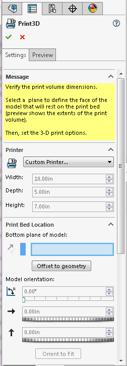

Printer - Custom Printer - Width
ISldWorks::GetUserPreferenceDoubleValue(swUserPreferenceDoubleValue_e.swPrint3DBoxX)
ISldWorks::SetUserPreferenceDoubleValue(swUserPreferenceDoubleValue_e.swPrint3DBoxX, <Value>)
Double value
Printer - Custom Printer - Depth
ISldWorks::GetUserPreferenceDoubleValue(swUserPreferenceDoubleValue_e.swPrint3DBoxY)
ISldWorks::SetUserPreferenceDoubleValue(swUserPreferenceDoubleValue_e.swPrint3DBoxY, <Value>)
Printer - Custom Printer - Height
ISldWorks::GetUserPreferenceDoubleValue(swUserPreferenceDoubleValue_e.swPrint3DBoxZ)
ISldWorks::SetUserPreferenceDoubleValue(swUserPreferenceDoubleValue_e.swPrint3DBoxZ, <Value>)
