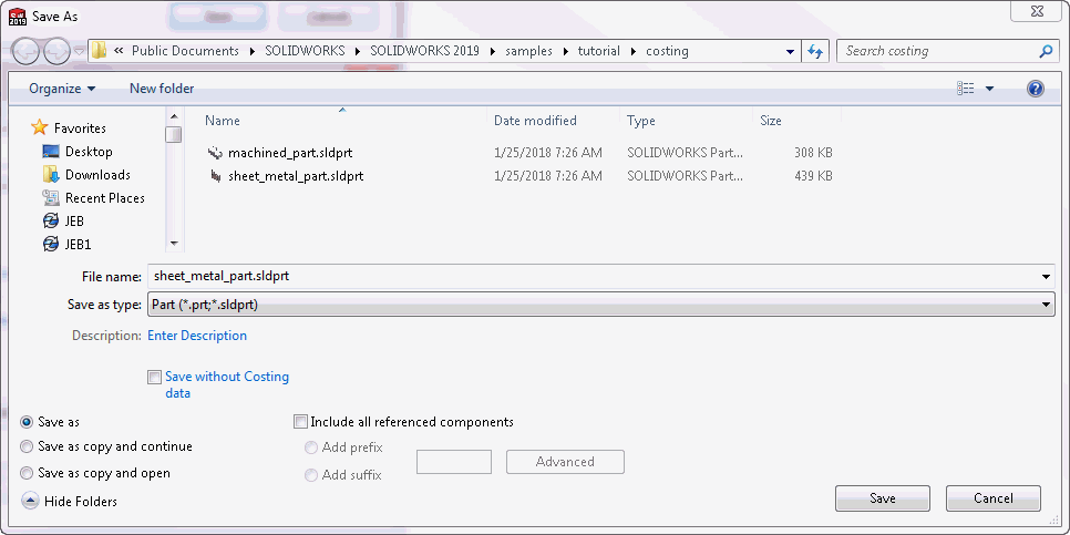

Save without Costing data
ISldWorks::GetUserPreferenceToggle(swUserPreferenceToggle_e.swSaveWithoutCostingData)
ISldWorks::SetUserPreferenceToggle(swUserPreferenceToggle_e.swSaveWithoutCostingData, <OnFlag>)
Boolean value
Specifies whether to save the sheet metal part without any Costing data

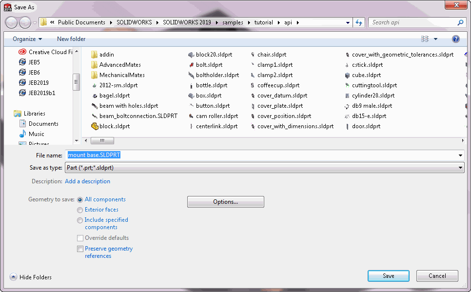

Geometry to save:
  • Exterior faces
  • Exterior components
  • All components
ISldWorks::GetUserPreferenceIntegerValue(swUserPreferenceIntegerValue_e.swSaveAssemblyAsPartOptions)
ISldWorks::SetUserPreferenceIntegerValue(swUserPreferenceIntegerValue_e.swSaveAssemblyAsPartOptions, swSaveAsmAsPartOptions_e.<Value>)
See swSaveAsmAsPartOptions_e for valid options
Specifies the geometry of an assembly to save as a multi-body part
Preserve geometry references
ISldWorks::GetUserPreferenceToggle(swUserPreferenceToggle_e.swSaveAsmAsPartPreserveIDs)
ISldWorks::SetUserPreferenceToggle(swUserPreferenceToggle_e.swSaveAsmAsPartPreserveIDs, <OnFlag>)
Boolean value
Specifies whether to preserve geometry reference IDs when saving an assembly as a part

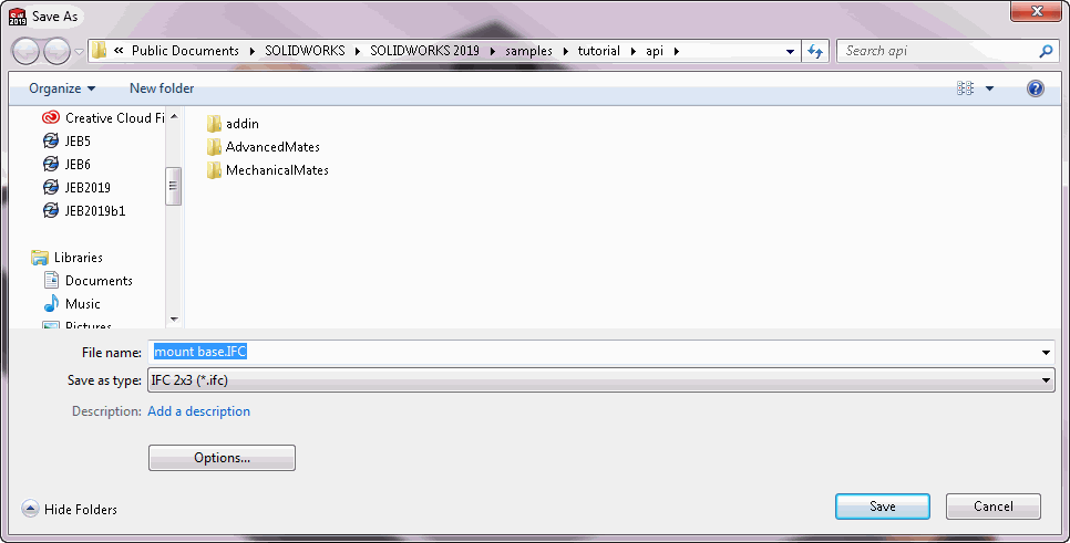

Save as type - IFC 2x3 or IFC 4
ISldWorks::GetUserPreferenceIntegerValue(swUserPreferenceIntegerValue_e.swSaveIFCFormat)
ISldWorks::SetUserPreferenceIntegerValue(swUserPreferenceIntegerValue_e.swSaveIFCFormat, <Value>)
  • 23 = IFC 2x3
  •   4 = IFC 4
Specifies the IFC format in which to save a part
