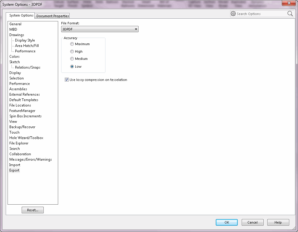

System Options > Export > 3DPDF
To display the dialog:
Click Tools > Options > System Options > Export > 3DPDF in File Format.
- or -
  1. Click File > Save As.
  2. In Save as type, select Adobe Portable Document Format.
  3. Select Save as 3D PDF.
  4. Click Options.
Setting
Get/Set Methods
Return Value
or
<OnFlag>
Comment
Accuracy - Maximum, High, Medium, or Low
ISldWorks::GetUserPreferenceIntegerValue(swUserPreferenceIntegerValue_e.sw3DPDFAccuracy)
ISldWorks::SetUserPreferenceIntegerValue(swUserPreferenceIntegerValue_e.sw3DPDFAccuracy, sw3DPDFAccuracy_e.<Value>)
See sw3DPDFAccuracy_e for valid options
Use lossy compression on tessellation
ISldWorks::GetUserPreferenceToggle(swUserPreferenceToggle_e.sw3DPDFCompressLossyTessellation)
ISldWorks::SetUserPreferenceToggle(swUserPreferenceToggle_e.sw3DPDFCompressLossyTessellation, <OnFlag>)
Boolean value
Specifies whether to use lossy compression on tessellation
