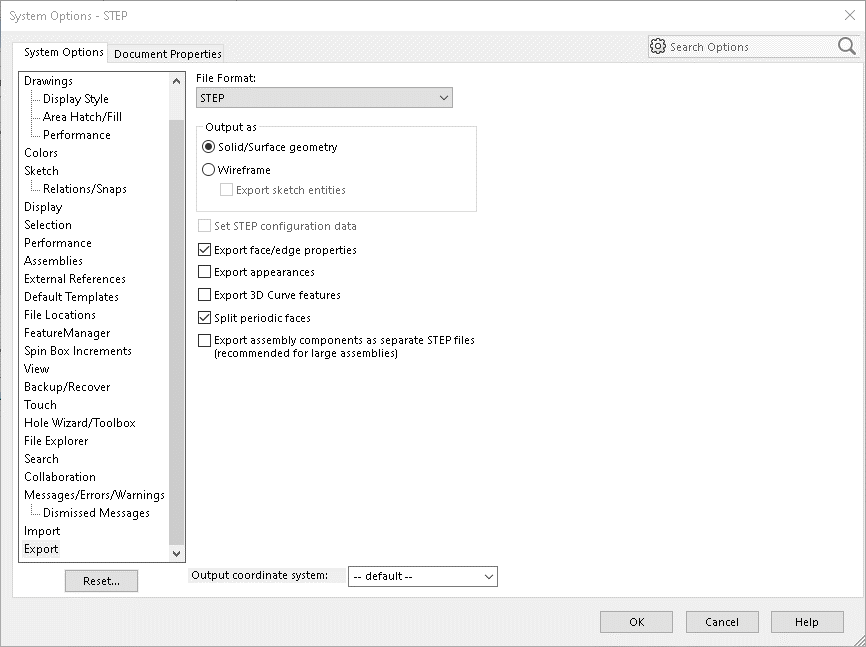

System Options > Export > STEP
This topic contains two tables. The information in the table:
  • appearing immediately after the screen capture corresponds to the settings on that dialog.
  • titled Miscellaneous Enumerators contains enumerators related to saving STEP data.
  • titled Obsolete Enumerators contains enumerators that previously appeared on the dialog but are now obsolete.
To display the dialog:
Click Tools > Options > System Options > Export > STEP in File Format.
- or -
  1. Click File > Save As.
  2. In Save as type, select STEP AP203 or STEP AP214.
  3. Click Options.
Setting
Get/Set Methods
Return Value
or
<Value>
Comment
Output as - Solid/Surface geometry
ISldWorks::GetUserPreferenceIntegerValue(swUserPreferenceIntegerValue_e.swStepExportPreference)
ISldWorks::SetUserPreferenceIntegerValue(swUserPreferenceIntegerValue_e.swStepExportPreference, swAcisOutputGeometryPreference_e.swAcisOutputAsSolidAndSurface)
Output as - Wireframe
ISldWorks::SetUserPreferenceIntegerValue(swUserPreferenceIntegerValue_e.swStepExportPreference, swAcisOutputGeometryPreference_e.swAcisOutputAs3DCurves)
Output as - Wireframe - Export sketch entities
ISldWorks::SetUserPreferenceIntegerValue(swUserPreferenceIntegerValue_e.swStepExportPreference, swAcisOutputGeometryPreference_e.swAcisOutputAs3DCurves_IncludeSketchEnts)
Set STEP configuration data
ISldWorks::GetUserPreferenceToggle(swUserPreferenceToggle_e.swStepExportConfigurationData, swUserPreferenceOption_e.swDetailingNoOptionSpecified)
ISldWorks::SetUserPreferenceToggle(swUserPreferenceToggle_e.swStepExportConfigurationData, swUserPreferenceOption_e.swDetailingNoOptionSpecified, <Value>)
Boolean value
Specifies whether to export STEP configuration data
Export face/edge properties
ISldWorks::GetUserPreferenceToggle(swUserPreferenceToggle_e.swStepExportFaceEdgeProps)
ISldWorks::SetUserPreferenceToggle(swUserPreferenceToggle_e.swStepExportFaceEdgeProps, <OnFlag>)
Boolean value
Specifies whether to export face and edge properties
Export appearances
ISldWorks::GetUserPreferenceToggle(swUserPreferenceToggle_e.swStepExportAppearances)
ISldWorks::SetUserPreferenceToggle(swUserPreferenceToggle_e.swStepExportAppearances, <OnFlag>)
Boolean value
Split periodic faces
ISldWorks::GetUserPreferenceToggle(swUserPreferenceToggle_e.swStepExportSplitPeriodic)
ISldWorks::SetUserPreferenceToggle(swUserPreferenceToggle_e.swStepExportSplitPeriodic, <OnFlag>)
Boolean value
Specifies whether to split periodic faces on export
Export 3D Curve features
ISldWorks::GetUserPreferenceToggle(swUserPreferenceToggle_e.swStepExport3DCurveFeatures)
ISldWorks::SetUserPreferenceToggle(swUserPreferenceToggle_e.swStepExport3DCurveFeatures, <OnFlag>)
Boolean value
Specifies whether to include 3D curve features in the exported file
Export assembly components as separate STEP files (recommended for large assemblies)
ISldWorks::GetUserPreferenceToggle(swUserPreferenceToggle_e.swStepExportAtomicSave)
ISldWorks::SetUserPreferenceToggle(swUserPreferenceToggle_e.swStepExportAtomicSave, <OnFlag>)
Boolean value
Output coordinate system
ISldWorks::GetUserPreferenceStringValue(swUserPreferenceStringValue_e.swExportOutputCoordinateSystem)
ISldWorks::SetUserPreferenceStringValue(swUserPreferenceStringValue_e.swExportOutputCoordinateSystem, <Value>)
String value
