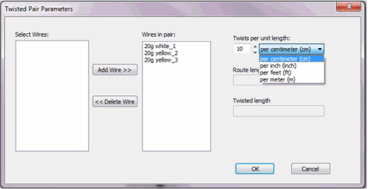

Twisted Pair Parameters
Setting
Get/Set Methods
Return Value or <Value>
Comments
Twists per unit length - spin box IModelDocExtension::GetUserPreferenceInteger(swUserPreferenceIntegerValue_e.swTwistCountValue, swUserPreferenceOption_e.swDetailingNoOptionSpecified)
IModelDocExtension::SetUserPreferenceInteger(swUserPreferenceIntegerValue_e.swTwistCountValue, swUserPreferenceOption_e.swDetailingNoOptionSpecified, <Value>)
Integer value Specifies the number of twists per unit length that the wires require in an electrical route; see SOLIDWORKS Routing Help for details about twisted pairs
Twists per meter IModelDocExtension::GetUserPreferenceDouble(swUserPreferenceDoubleValue_e.swTwistCountValuePerMeter, swUserPreferenceOption_e.swDetailingNoOptionSpecified)
IModelDocExtension::SetUserPreferenceDouble(swUserPreferenceDoubleValue_e.swTwistCountValuePerMeter, swUserPreferenceOption_e.swDetailingNoOptionSpecified, <Value>)
Double value
For example:
If swTwistCountValue is... Desired unit is... Then swTwistCountValuePerMeter is...
 10
per centimeter (cm) 1000 (1 m = 100 cm)
per inch (inch) 393.7 (1 m = 39.37 in)
per feet (ft) 32.8 (1 m = 3.28 ft)
per meter (m) 10
Specifies the number of twists per meter for the twisted pairs in an electrical route; see SOLIDWORKS Routing Help for details about twisted pairs
