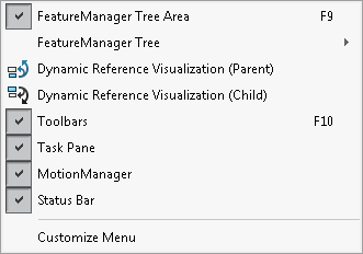

View > User Interface
Setting
Get/Set Methods
Return Value
or
<Value>
or
<OnFlag>
Comment
Dynamic Reference Visualization (Parent)
ISldWorks::GetUserPreferenceToggle(swUserPreferenceToggle_e.swDynamicReferenceVisualization_Parent)
ISldWorks::SetUserPreferenceToggle(swUserPreferenceToggle_e.swDynamicReferenceVisualization_Parent, <OnFlag>)
Boolean value
Specifies whether to display parent relationships
Dynamic Reference Visualization (Child)
ISldWorks::GetUserPreferenceToggle(swUserPreferenceToggle_e.swDynamicReferenceVisualization_Child)
ISldWorks::SetUserPreferenceToggle(swUserPreferenceToggle_e.swDynamicReferenceVisualization_Child, <OnFlag>)
Boolean value
Specifies whether to display child relationships
