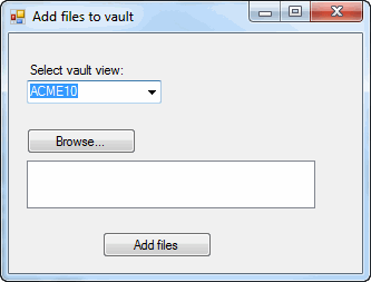

' 1. Displays the Add files to vault dialog box.
'    a. Select a vault view.
'    b. Click Browse
'       1. Locate and click three files outside the vault.
'       2. Click Open.
'    c. Click Add files.

'Form1.vb

        'OpenFileDialog
        Me.OpenFileDialog.Multiselect = True
        Me.OpenFileDialog.Title = "Open"
        'Form1
        Me.AutoScaleDimensions = New System.Drawing.SizeF(6.0!, 13.0!)
        Me.AutoScaleMode = System.Windows.Forms.AutoScaleMode.Font
        Me.ClientSize = New System.Drawing.Size(317, 215)
        Me.Controls.Add(Me.AddFiles)
        Me.Controls.Add(Me.ListBox)
        Me.Controls.Add(Me.BrowseButton)
        Me.Controls.Add(Me.VaultsComboBox)
        Me.Controls.Add(Me.VaultsLabel)
        Me.Name = "Form1"
        Me.Text = "Add files to vault"
        Me.ResumeLayout(False)
        Me.PerformLayout()
    End Sub
#End Region
    Friend WithEvents VaultsLabel As System.Windows.Forms.Label
    Friend WithEvents VaultsComboBox As System.Windows.Forms.ComboBox
    Friend WithEvents BrowseButton As System.Windows.Forms.Button
    Friend WithEvents ListBox As System.Windows.Forms.ListBox
    Friend WithEvents AddFiles As System.Windows.Forms.Button
    Friend WithEvents OpenFileDialog As System.Windows.Forms.OpenFileDialog
End Class
