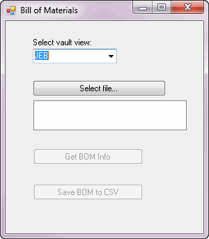

' 1. The Bill of Materials dialog box displays.
'    a. Select a vault_name view.
'    b. Click Select file.
'    c. In the Select File dialog:
'       1. Click the assembly specified in Preconditions step 5.
'       2. Click Open.
'    d. Click Get BOM.
'       Displays message boxes containing:
'       * Version information for the named BOM.
'       * Row and column information about a BOM view in the BOM layout
'         for the selected assembly.
'    e. Click OK in each message box.
' 2. Inserts a row for "temp" after the first row in the BOM.
' 3. Close the Bill of Materials dialog box.
4. Verify the new row in the named BOM of the assembly in vault_name view.
