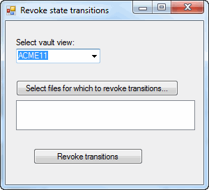

// Postconditions:
//  1. The Revoke state transitions dialog box displays.
//     a. Select a vault view.
//     b. Click Select files for which to revoke transitions.
//     c. In the Select File dialog:
//        1. Select a file that transitioned to the Approved state using the
//           No Approval Required transition.
//        2. Click Open.
//  2. Click Revoke transitions.
//  3. Click OK in the Revoke Transition dialog box.
//     The selected file's No Approval Required transition is revoked.
//  4. Close the Revoke state transitions dialog box.

            this.Text = "Revoke state transitions";
