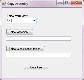

// Postconditions:
// 1. Displays the Copy Assembly dialog box.
//    a. Select a vault view.
//    b. Click Select assembly
//       Locate and double-click an assembly.
//    c. Click Select a destination folder.
//       1. Locate and select New Folder.
//       2. Click OK.
//    d. Click Copy tree.
//       The Copy Tree dialog shows the files to copy.
//    e. Click Copy
//       The Copying tree progress bar appears.
//    f. Inspect the destination folder.
// 2. Close the Copy Assembly dialog box.
