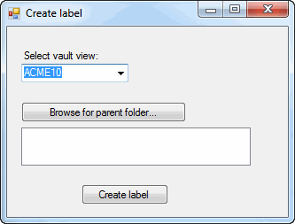

' 1. Displays the Create label dialog box.
'    a. Select a vault view.
'    b. Click Browse for parent folder
'       1. Locate and click a folder in the vault.
'       2. Click OK.
'    c. Click Create label.
'       1. Creates label, MyCompany, on the selected folder and all of its
'          subfolders and files.
'       2. Displays a message box with information about all of the labels
'          on the selected folder.
'       3. Click OK.

        Me.Text = "Create label"
