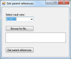

// 1. The Get parent references dialog displays.
// 2. Select a vault view.
// 3. Click Browse for file.
// 4. Locate and click one of the parts mentioned in Preconditions step 4.
// 5. Click Open.
// 6. Click Get parent references.
// 7. Displays the references of the selected part.
// 8. Click OK.
// 9. Close the Get parent references dialog.

            this.Text = "Get parent references";
