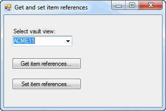

// Postconditions:
// 1. Displays the Get and set item references dialog box.
// 2. Select a vault view.
// 3. Click Get item references
//    a. Click an item folder in the vault.
//    b. Click OK.
//    c. Displays a message box confirming your folder selection.
//    d. Click OK.
//    e. Displays a message box with item references for the first item found
//       in the selected folder.
//    f. Click OK.
// 4. Click Set item references.
//    a. Click one or more files to add as references to the item.
//    b. Click Open.
//    c. Displays a message box with the updated references.
//       - or -
//       Displays a message box with errors.
//    d. Click OK.
// 5. Close the Get and set item references dialog box.

            //GetItemRefs
            this.GetItemRefs.Location = new System.Drawing.Point(16, 86);
            this.GetItemRefs.Name = "GetItemRefs";
            this.GetItemRefs.Size = new System.Drawing.Size(139, 23);
            this.GetItemRefs.TabIndex = 5;
            this.GetItemRefs.Text = "Get item references...";
            this.GetItemRefs.UseVisualStyleBackColor = true;
            this.GetItemRefs.Click +=new System.EventHandler(GetItemRefs_Click);
            //OpenFileDialog
            this.OpenFileDialog.Title = "Open";
            //Button1
            this.Button1.Location = new System.Drawing.Point(16, 127);
            this.Button1.Name = "Button1";
            this.Button1.Size = new System.Drawing.Size(139, 23);
            this.Button1.TabIndex = 6;
            this.Button1.Text = "Set item references...";
            this.Button1.UseVisualStyleBackColor = true;
            this.Button1.Click +=new System.EventHandler(Button1_Click);
            //Form1
            this.AutoScaleDimensions = new System.Drawing.SizeF(6f, 13f);
            this.AutoScaleMode = System.Windows.Forms.AutoScaleMode.Font;
            this.ClientSize = new System.Drawing.Size(317, 185);
            this.Controls.Add(this.Button1);
            this.Controls.Add(this.GetItemRefs);
            this.Controls.Add(this.VaultsComboBox);
            this.Controls.Add(this.VaultsLabel);
            this.Name = "Form1";
            this.Text = "Get and set item references";
            this.Load += new System.EventHandler(this.Form1_Load);
            this.ResumeLayout(false);
            this.PerformLayout();
