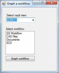

' 1. Displays the Graph a workflow dialog box.
' 2. Maximize the dialog box for the workflow graph.
' 3. Select a vault view.
' 4. Click a workflow.
' 5. Click Graph workflow
' 6. Graphs the selected workflow in the dialog box.
' 7. Close the Graph a workflow dialog box.

    Public Sub GraphWorkflow_Click(ByVal sender As System.ObjectByVal e As System.EventArgsHandles GraphWorkflow.Click
        'Graph workflow
        Try

    Private Sub VaultsComboBox_SelectedIndexChanged(ByVal sender As System.ObjectByVal e As System.EventArgsHandles VaultsComboBox.SelectedIndexChanged
        Try
            vault1 = New EdmVault5()
            Dim vault As IEdmVault8 = DirectCast(vault1, IEdmVault8)
            If Not vault1.IsLoggedIn Then
                vault1.LoginAuto(VaultsComboBox.Text, Me.Handle.ToInt32())
            End If
            ListBox1.Items.Clear()
            wfmgr = vault.CreateUtility(EdmUtility.EdmUtil_WorkflowMgr)
            pos = wfmgr.GetFirstWorkflowPosition()
            While Not pos.IsNull
                wf = wfmgr.GetNextWorkflow(pos)
                ListBox1.Items.Add(wf.Name)
            End While

        Me.Label1.Text = "Select workflow:"
        'Form1
        Me.AutoScaleDimensions = New System.Drawing.SizeF(6.0!, 13.0!)
        Me.AutoScaleMode = System.Windows.Forms.AutoScaleMode.Font
        Me.ClientSize = New System.Drawing.Size(227, 262)
        Me.Controls.Add(Me.Label1)
        Me.Controls.Add(Me.ListBox1)
        Me.Controls.Add(Me.GraphWorkflow)
        Me.Controls.Add(Me.VaultsComboBox)
        Me.Controls.Add(Me.VaultsLabel)
        Me.Name = "Form1"
        Me.Text = "Graph a workflow"
