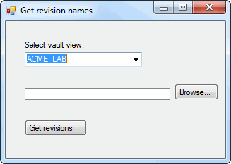

//10. Replace the code in Form1.cs with this code. //11. To create the form, replace the code in Form1.Designer.cs with  //    this code. //12. To find a checked-in file with a revision scheme and at least three // revisions in the current version: //    a. Open a vault view in File Explorer. //    b. Click a checked-in file. //    c. Click Display > History. //    d. Examine the Event column. If Revision is: //       * listed in the Event column, then the file   //         has a revision scheme. Scroll down and examine the // Event and Version columns to verify that at least three // revisions exist for the current version of the file. //       * not listed in the Event column, then //         repeat steps 4b - 4d until you find a checked-in file  //         with a revision scheme and at least three revisions for // the current version.  //13. Click Debug > Start Debugging or press F5. // // Postconditions:  // 1. Displays the Get revision names dialog box. // 2. Select a vault view. // 3. Click Browse. // 4. Displays the Select a file dialog box. //    a. Click the file identified in Preconditions step 4 in the  //       selected vault. //    b. Click Open to display the selected file's path and file   //       name in the Get revision names dialog box. // 5. Click Get revisions // 6. Displays a message box listing the names of the revisions  // for the selected file. Click OK to close the message box. // 7. Displays a message box showing the revision to which the file // was rolled back and the current version. Click OK to close the // message box. // 8. Close the Get revision names dialog box. // 9. Click the file in the vault in File Explorer for which revisions // were rolled back. //    a. Click Display > History. //    b. Scroll down and examine the Event, Version, and Comment columns. //---------------------------------------------------------------------------- //Form1.cs using EPDM.Interop.epdm; using System.Windows.Forms; using System; namespace RevisionCSharp {     public partial class Form1 : Form     {         public Form1()         {             InitializeComponent();         }         IEdmVault5 vault1 = null;         IEdmVault8 vault = null;         IEdmFile5 aFile;         IEdmFolder5 folder;         private void Form1_Load(System.Object sender, System.EventArgs e)         {             try             {                 vault1 = new EdmVault5();                 vault = (IEdmVault8)vault1;                 EdmViewInfo[] Views = { };                 vault.GetVaultViews(out Views, false);                 VaultsComboBox.Items.Clear();                 foreach (EdmViewInfo View in Views)                 {                     VaultsComboBox.Items.Add(View.mbsVaultName);                 }                 if (VaultsComboBox.Items.Count > 0)                 {                     VaultsComboBox.Text = (string)VaultsComboBox.Items[0];                 }             }             catch (System.Runtime.InteropServices.COMException ex)             {                 MessageBox.Show("HRESULT = 0x" + ex.ErrorCode.ToString("X") + "\n" + ex.Message);             }             catch (Exception ex)             {                 MessageBox.Show(ex.Message);             }         }         public void RevisionButton_Click(System.Object sender, System.EventArgs e)         {             try             {                 //Only create a new vault object                 //if one hasn't been created yet                 if (vault1 == null)                 {                     vault1 = new EdmVault5();                 }                 if (!vault1.IsLoggedIn)                 {                     //Log into selected vault as the current user                     vault1.LoginAuto(VaultsComboBox.Text, this.Handle.ToInt32());                 }                 //Get the local version number                 int version = 0;                 version = aFile.GetLocalVersionNo(folder.ID);                 if (version < 1)                 {                     MessageBox.Show("A local copy of " + aFile.Name + " does not exist.");                     return;                 }                 //Get the version interface                 IEdmEnumeratorVersion7 verEnum = default(IEdmEnumeratorVersion7);                 verEnum = (IEdmEnumeratorVersion7)aFile;                 IEdmVersion8 ver = default(IEdmVersion8);                 ver = (IEdmVersion8)verEnum.GetVersion(version);                 //Enumerate the revisions                 string message = null;                 IEdmPos5 pos = default(IEdmPos5);                 pos = ver.GetFirstRevisionPosition(); IEdmRevision7 rev = default(IEdmRevision7); int verNbr = 0;                 if (!pos.IsNull)                 {                     message = "The following revisions are set on " + aFile.Name + ": " + "\n";                     while (!pos.IsNull)                     {                         rev = (IEdmRevision7)ver.GetNextRevision(pos);                         message = message + "    " + rev.Name + "\n"; verNbr = rev.VersionNo;                     }                 }                 else                 {                     message = "A revision scheme is not defined for " + aFile.Name + "." + "\n";                     MessageBox.Show(message);                     return;                 }                 MessageBox.Show(message);

            this.Text = "Get revision names";
