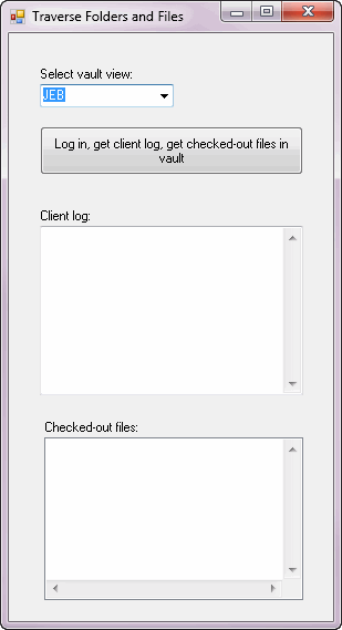

This example shows how to recursively traverse all of the folders and files in a vault.
NOTE: If using the primary interop assembly provided with SOLIDWORKS PDM Professional, see Using .NET Framework 4.0 in Stand-alone Applications.
// Preconditions:
//  1. Start Microsoft Visual Studio.
//  2. Click File > New > Project > Dropdowns: C#, Windows, Desktop > Windows Forms App. Click Next.
//  3. Type TraverseFilesFoldersCSharp in Project name.
//  4. In Location click ... and navigate to the folder where to create the project. Click Next.
//  5. Select a supported .NET Framework installed on your computer. Click Create.
//  6. Replace the code in Form1.cs with this code.
//  7. Replace the code in Form1.Designer.cs with this code.
//  8. Add "using TraverseFilesAndFoldersCSharp;" to the top of Program.cs.
//  9. Add EPDM.Interop.epdm.dll as a reference (right-click the project
//     name in the Solution Explorer, click Add > Project Reference, click Browse
//     navigate to the top folder of your SOLIDWORKS PDM Professional installation,
//     locate and select EPDM.Interop.epdm.dll). Click OK.
// 10. Click Show All Files in the tool bar. Right-click Dependencies > Assemblies >
//     EPDM.Interop.epdm, click Properties, and set
//     Embed Interop Types to No to handle methods that pass arrays of
//     structures.
// 11. Ensure that the vault contains one or more checked-out files.
// 12. Click Debug > Start Debugging or press F5.
// Postconditions:
// 1. Displays a Traverse Folders and Files dialog.
// 2. Select a vault.
// 3. Click Log in, get client log, get checked-out files in vault.
// 4. Displays a message box with the vault type.
// 5. Click OK.
// 6. Populates Client log and Checked-out files.
// 7. Close the dialog.

            this.Text = "Traverse Folders and Files";
