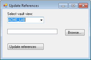

Update References Example (C#)
This example shows how to update the references of a file in a vault.
NOTE: If using the primary interop assembly provided with SOLIDWORKS PDM Professional, see Using .NET Framework 4.0 in Stand-alone Applications.
// Preconditions:
// 1. Start Microsoft Visual Studio.
// 2. Click File > New > Project > C#,
Windows, Desktop > Windows Forms App.
// 3. Type UpdateReferencesCSharp in Project name.
// 4. For Location, click ... and navigate to the folder where to create the project.
// 5. Click Next
// 6. Select Framework.
// 7. Click Create.
// 8. Click Show All Files in the Solution Explorer toolbar and expand
//    Form1.cs in the Solution Explorer.
// 9. Add dependencies and safely pass arrays of structures.
//10. Replace the code in Form1.cs with this code. //11. To create the form, replace the code in Form1.Designer.cs with  //    this code. //12. Click Debug > Start Debugging or press F5. // // Postconditions:  //  1. Displays your Update References dialog box. //  2. Select a vault view. //  3. Click Browse. //  4. Displays the Select a file dialog box. //     a. Click a file in the selected vault. //     b. Click Open. //     The selected file's path and file name appear  //     in the Select a file dialog box. //  5. Click Update references. //  6. Initializes and displays SOLIDWORKS PDM Professional's Update References   //     dialog box, which shows the name of the selected file whose file references  //     to update and the names of the file references, if any. //  7. Click Close. //  8. Close your Update References dialog box. //----------------------------------------------------------------------------
