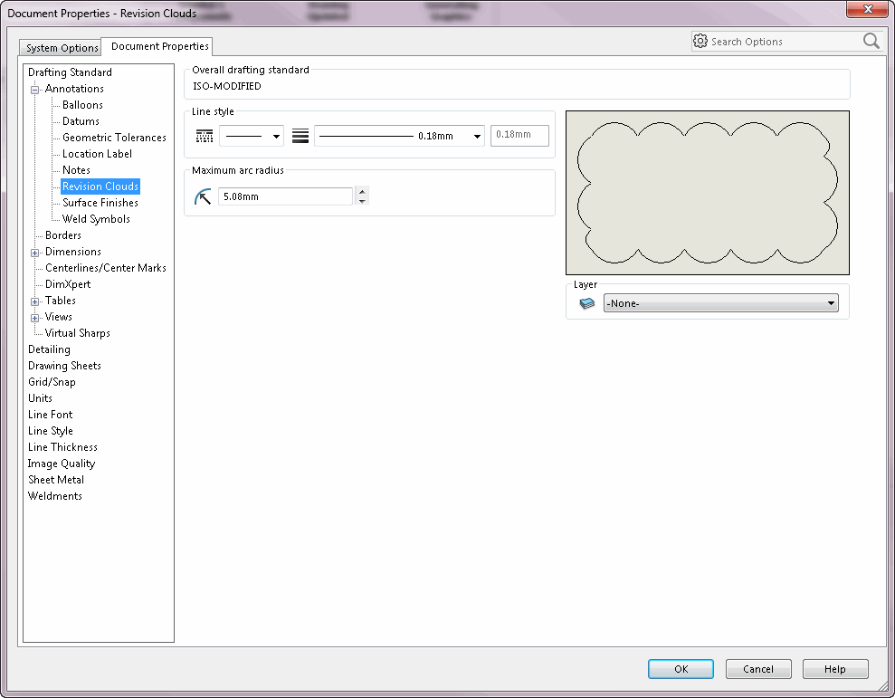

Document Properties > Annotations > Revision Clouds
Setting
Get/Set Methods
Return Value or <Value>
Comments
Overall drafting standard
IModelDocExtension::GetUserPreferenceInteger(swUserPreferenceIntegerValue_e.swDetailingDimensionStandard, swUserPreferenceOption_e.swDetailingRevisionCloud)
IModelDocExtension::SetUserPreferenceInteger(swUserPreferenceIntegerValue_e.swDetailingDimensionStandard, swUserPreferenceOption_e.swDetailingRevisionCloud, swDetailingStandard_e.<Value>)
See swDetailingStandard_e for valid options
Specifies the overall drafting standard
Line style - Frame Style
IModelDocExtension::GetUserPreferenceInteger(swUserPreferenceIntegerValue_e.swDetailingRevisionCloudLineStyle, swUserPreferenceOption_e.swDetailingRevisionCloud)
IModelDocExtension::SetUserPreferenceInteger(swUserPreferenceIntegerValue_e.swDetailingRevisionCloudLineStyle, swUserPreferenceOption_e.swDetailingRevisionCloud, swLineStyles_e.<Value>)
See swLineStyles_e for valid options
Specifies the style of the frames of revision clouds
Line style - Frame Thickness
IModelDocExtension::GetUserPreferenceInteger(swUserPreferenceIntegerValue_e.swDetailingRevisionCloudLineThickness, swUserPreferenceOption_e.swDetailingRevisionCloud)
IModelDocExtension::SetUserPreferenceInteger(swUserPreferenceIntegerValue_e.swDetailingRevisionCloudLineThickness, swUserPreferenceOption_e.swDetailingRevisionCloud, swLineWeights_e.<Value>)
See swLineWeights_e for valid options
Specifies the thickness of the frames of revision clouds
Line style - Custom Thickness
IModelDocExtension::GetUserPreferenceDouble(swUserPreferenceDoubleValue_e.swDetailingRevisionCloudLineThicknessCustom, swUserPreferenceOption_e.swDetailingRevisionCloud)
IModelDocExtension::SetUserPreferenceDouble(swUserPreferenceDoubleValue_e.swDetailingRevisionCloudLineThicknessCustom, swUserPreferenceOption_e.swDetailingRevisionCloud, <Value>)
Double value
Specifies a custom thickness for the frames of revision clouds; sets Custom Thickness to the specified thickness and Frame Thickness to Custom Size
Maximum arc radius
IModelDocExtension::GetUserPreferenceDouble(swUserPreferenceDoubleValue_e.swDetailingRevisionCloudMaxArcRadius, swUserPreferenceOption_e.swDetailingRevisionCloud)
IModelDocExtension::SetUserPreferenceDouble(swUserPreferenceDoubleValue_e.swDetailingRevisionCloudMaxArcRadius, swUserPreferenceOption_e.swDetailingRevisionCloud, <Value>)
Double value
Specifies the maximum radius of each frame arc
Layer
IModelDocExtension::GetUserPreferenceString(swUserPreferenceStringValue_e.swDetailingLayer, swUserPreferenceOption_e.swDetailingRevisionCloud)
IModelDocExtension::SetUserPreferenceString(swUserPreferenceStringValue_e.swDetailingLayer, swUserPreferenceOption_e.swDetailingRevisionCloud, <Value>)
Valid Options:
  • "Border"
  • "Dimensions"
  • "Notes"
  • "BOM"
  • "FORMAT"
This setting is available only on drawings; depending on drawing, some options may not apply
