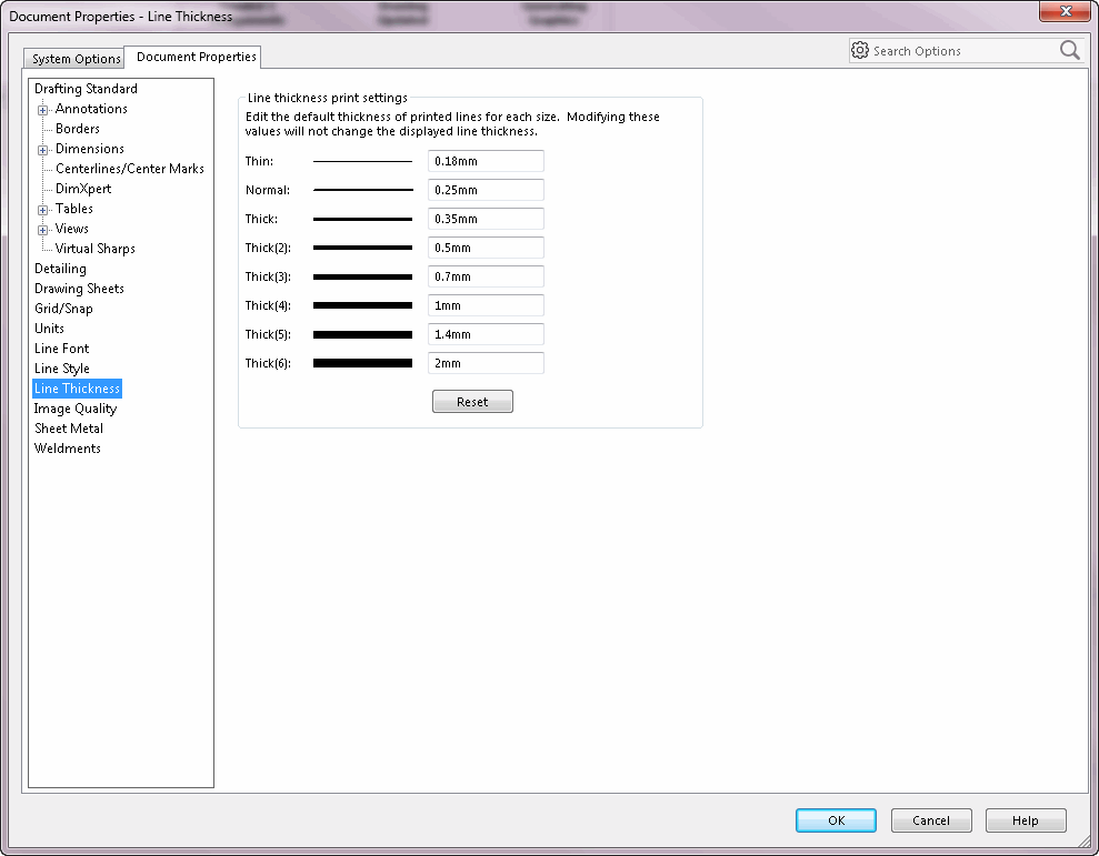

Document Properties > Line Thickness
Setting
Get/Set Methods
Return Value or <Value>
Comments
Line thickness print settings - Thin
IModelDocExtension::GetUserPreferenceDouble(swUserPreferenceDoubleValue_e.swPageSetupPrinterThinLineWeight, swUserPreferenceOption_e.swDetailingNoOptionSpecified)
IModelDocExtension::SetUserPreferenceDouble(swUserPreferenceDoubleValue_e.swPageSetupPrinterThinLineWeight, swUserPreferenceOption_e.swDetailingNoOptionSpecified, <Value>)
Double value in meters
Specifies weight of thin line setting
Line thickness print settings - Normal
IModelDocExtension::GetUserPreferenceDouble(swUserPreferenceDoubleValue_e.swPageSetupPrinterNormalLineWeight, swUserPreferenceOption_e.swDetailingNoOptionSpecified)
IModelDocExtension::SetUserPreferenceDouble(swUserPreferenceDoubleValue_e.swPageSetupPrinterNormalLineWeight, swUserPreferenceOption_e.swDetailingNoOptionSpecified, <Value>)
Specifies weight of normal line setting
Line thickness print settings - Thick
IModelDocExtension::GetUserPreferenceDouble(swUserPreferenceDoubleValue_e.swPageSetupPrinterThickLineWeight, swUserPreferenceOption_e.swDetailingNoOptionSpecified)
IModelDocExtension::SetUserPreferenceDouble(swUserPreferenceDoubleValue_e.swPageSetupPrinterThickLineWeight, swUserPreferenceOption_e.swDetailingNoOptionSpecified, <Value>)
Specifies weight of first thick line setting
Line thickness print settings - Thick(2)
IModelDocExtension::GetUserPreferenceDouble(swUserPreferenceDoubleValue_e.swPageSetupPrinterThick2LineWeight, swUserPreferenceOption_e.swDetailingNoOptionSpecified)
IModelDocExtension::SetUserPreferenceDouble(swUserPreferenceDoubleValue_e.swPageSetupPrinterThick2LineWeight, swUserPreferenceOption_e.swDetailingNoOptionSpecified, <Value>)
Specifies weight of second thick line setting
Line thickness print settings - Thick(3)
IModelDocExtension::GetUserPreferenceDouble(swUserPreferenceDoubleValue_e.swPageSetupPrinterThick3LineWeight, swUserPreferenceOption_e.swDetailingNoOptionSpecified)
IModelDocExtension::SetUserPreferenceDouble(swUserPreferenceDoubleValue_e.swPageSetupPrinterThick3LineWeight, swUserPreferenceOption_e.swDetailingNoOptionSpecified, <Value>)
Specifies weight of third thick line setting
Line thickness print settings - Thick(4)
IModelDocExtension::GetUserPreferenceDouble(swUserPreferenceDoubleValue_e.swPageSetupPrinterThick4LineWeight, swUserPreferenceOption_e.swDetailingNoOptionSpecified)
IModelDocExtension::SetUserPreferenceDouble(swUserPreferenceDoubleValue_e.swPageSetupPrinterThick4LineWeight, swUserPreferenceOption_e.swDetailingNoOptionSpecified, <Value>)
Specifies weight of fourth thick line setting
Line thickness print settings - Thick(5)
IModelDocExtension::GetUserPreferenceDouble(swUserPreferenceDoubleValue_e.swPageSetupPrinterThick5LineWeight, swUserPreferenceOption_e.swDetailingNoOptionSpecified)
IModelDocExtension::SetUserPreferenceDouble(swUserPreferenceDoubleValue_e.swPageSetupPrinterThick5LineWeight, swUserPreferenceOption_e.swDetailingNoOptionSpecified, <Value>)
Specifies weight of fifth thick line setting
Line thickness print settings - Thick(6)
IModelDocExtension::GetUserPreferenceDouble(swUserPreferenceDoubleValue_e.swPageSetupPrinterThick6LineWeight, swUserPreferenceOption_e.swDetailingNoOptionSpecified)
IModelDocExtension::SetUserPreferenceDouble(swUserPreferenceDoubleValue_e.swPageSetupPrinterThick6LineWeight, swUserPreferenceOption_e.swDetailingNoOptionSpecified, <Value>)
Specifies weight of sixth thick line setting
