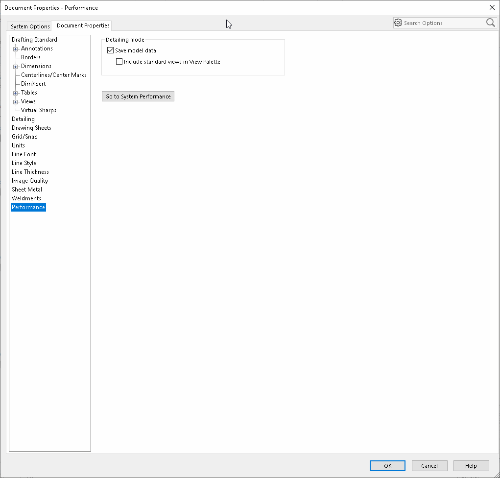

Document Properties > Performance
The Performance tab appears only when a drawing is open.
Setting
Get/Set Methods
Return Value or <Value>
Comments
Detailing mode - Save model data
IModelDocExtension::GetUserPreferenceToggle(swUserPreferenceToggle_e.swDetailingModeSaveModelData, swUserPreferenceOption_e.swDetailingNoOptionSpecified)
IModelDocExtension::SetUserPreferenceToggle(swUserPreferenceToggle_e.swDetailingModeSaveModelData, swUserPreferenceOption_e.swDetailingNoOptionSpecified, <OnFlag>)
Boolean value
Valid only for drawings
Detailing mode - Include standard views in View Palette
IModelDocExtension::GetUserPreferenceToggle(swUserPreferenceToggle_e.swDetailingModeIncludeStandardViewsInViewPalette, swUserPreferenceOption_e.swDetailingNoOptionSpecified)
IModelDocExtension::SetUserPreferenceToggle(swUserPreferenceToggle_e.swDetailingModeIncludeStandardViewsInViewPalette, swUserPreferenceOption_e.swDetailingNoOptionSpecified, <OnFlag>)
Boolean value
Valid only for drawings and when Save model data is set to true
