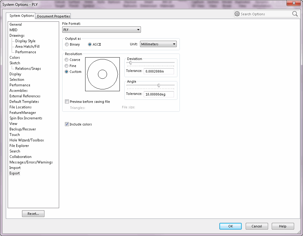

System Options > Export > PLY
To display the dialog:
Click Tools > Options > System Options > Export > PLY in File Format.
- or -
  1. Click File > Save As.
  2. In Save as type, select Polygon File Format.
  3. Click Options.
Setting
Get/Set Methods
Return Value
or
<Value>
or
<OnFlag>
Comment
Output as
ISldWorks::GetUserPreferenceToggle(swUserPreferenceToggle_e.swPLYBinaryFormat)
ISldWorks::SetUserPreferenceToggle(swUserPreferenceToggle_e.swPLYBinaryFormat, <OnFlag>)
Boolean value
Output as - Unit
ISldWorks::GetUserPreferenceIntegerValue(swUserPreferenceIntegerValue_e.swExportPlyUnits)
ISldWorks::SetUserPreferenceIntegerValue(swUserPreferenceIntegerValue_e.swExportPlyUnits, swLengthUnit_e.<Value>)
Integer value as defined in swLengthUnit_e
Resolution
ISldWorks::GetUserPreferenceIntegerValue(swUserPreferenceIntegerValue_e.swPLYQuality)
ISldWorks::SetUserPreferenceIntegerValue(swUserPreferenceIntegerValue_e.swPLYQuality, swPLYQuality_e.<Value>)
Integer value as defined in swPLYQuality_e
Resolution - Deviation Tolerance
ISldWorks::GetUserPreferenceDoubleValue(swUserPreferenceDoubleValue_e.swPLYDeviation)
ISldWorks::SetUserPreferenceDoubleValue(swUserPreferenceDoubleValue_e.swPLYDeviation, <Value>)
Double value in meters
Valid only if swPLYQuality is set to swPLYQuality_e.swPLYQuality_CUSTOM; the value range varies by part or assembly. Inspect the dialog for the range of values for the opened model.
Resolution - Angle Tolerance
ISldWorks::GetUserPreferenceDoubleValue(swUserPreferenceDoubleValue_e.swPLYAngleTolerance)
ISldWorks::SetUserPreferenceDoubleValue(swUserPreferenceDoubleValue_e.swPLYAngleTolerance, <Value>)
0.5236 >= Double value in radians >= 0.00873
Resolution - Preview before saving file
ISldWorks::GetUserPreferenceToggle(swUserPreferenceToggle_e.swPLYPreview)
ISldWorks::SetUserPreferenceToggle(swUserPreferenceToggle_e.swPLYPreview, <OnFlag>)
Boolean value
Include colors
ISldWorks::GetUserPreferenceToggle(swUserPreferenceToggle_e.swPLYIncludeColors)
ISldWorks::SetUserPreferenceToggle(swUserPreferenceToggle_e.swPLYIncludeColors, <OnFlag>)
Boolean value
