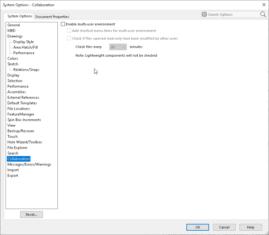

This topic contains two tables. The information in the table:
  • appearing immediately after the dialog corresponds to the settings on that dialog.
  • titled Obsolete Enumerators contains enumerators that previously appeared on the dialog but are now obsolete or have been moved to another location.
THe Collaboration settings are not supported in SOLIDWORKS Connected.
Setting
Get/Set Methods
Return Value
or
<Value>
or
<OnFlag>
Comment
Enable multi-user environment
(Not supported in SOLIDWORKS Connected)
ISldWorks::GetUserPreferenceToggle(swUserPreferenceToggle_e.swCollabEnableMultiuser) ISldWorks::SetUserPreferenceToggle(swUserPreferenceToggle_e.swCollabEnableMultiuser, <OnFlag>)
Boolean value
Specifies whether to  enable multi-user environment
Add shortcut menu items for multi-user environment
ISldWorks::GetUserPreferenceToggle(swUserPreferenceToggle_e.swCollabAddShortcutMenuItems) ISldWorks::SetUserPreferenceToggle(swUserPreferenceToggle_e.swCollabAddShortcutMenuItems, <OnFlag>)
Boolean value
Specifies whether to add shortcut menu items for multi-user environment
Check if files opened read-only have been modified by other users
ISldWorks::GetUserPreferenceToggle(swUserPreferenceToggle_e.swCollabCheckReadOnlyModifiedByOthers) ISldWorks::SetUserPreferenceToggle(swUserPreferenceToggle_e.swCollabCheckReadOnlyModifiedByOthers, <OnFlag>)
Boolean value
Specifies whether to check if files opened read-only have been modified by others; works with swUserPreferenceIntegerValue_e.swCollabCheckReadOnlyModifiedInterval
Check files every <n> minutes
ISldWorks::GetUserPreferenceIntegerValue(wUserPreferenceIntegerValue_e.swCollabCheckReadOnlyModifiedInterval)
ISldWorks::SetUserPreferenceIntegerValue(wUserPreferenceIntegerValue_e.swCollabCheckReadOnlyModifiedInterval, swCollabCheckReadOnlyModifiedInterval_e .<Value>)
See swCollabCheckReadOnlyModifiedInterval_e for valid options
Works with swUserPreferenceToggle_e.swCollabCheckReadOnlyModifiedByOthers
