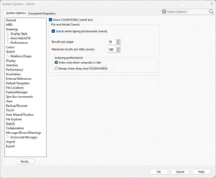

This topic contains two tables. The information in the table:
  • appearing immediately after the screen capture corresponds to the settings on that dialog.
  • titled Obsolete Enumerators contains enumerators that previously appeared on the dialog but are now obsolete.
The Search dialog is not available in SOLIDWORKS Connected.
Setting
Get/Set Methods
Return Value
or
<Value>
or
<OnFlag>
Comment
Show SOLIDWORKS search box
ISldWorks::GetUserPreferenceToggle(swUserPreferenceToggle_e.swSearchShowSOLIDWORKSSearchBox)
 ISldWorks::SetUserPreferenceToggle(swUserPreferenceToggle_e.swSearchShowSOLIDWORKSSearchBox, <OnFlag>)
Boolean value
Specifies whether to show the SOLIDWORKS search box
File and Model Search - Search while typing (incremental search)
(Not supported in SOLIDWORKS Connected)
ISldWorks::GetUserPreferenceToggle(swUserPreferenceToggle_e.swSearchWhileTyping)
ISldWorks::SetUserPreferenceToggle(swUserPreferenceToggle_e.swSearchWhileTyping, <OnFlag>)
Boolean value
Specifies whether to start the search while typing the search string
File and Model Search - Results per page
ISldWorks::GetUserPreferenceIntegerValue(swUserPreferenceIntegerValue_e.swSearchResultsPerPage)
ISldWorks::SetUserPreferenceIntegerValue(swUserPreferenceIntegerValue_e.swSearchResultsPerPage, <Value>)
Integer value
Specifies number of search results to show per page
File and Model Search - Maximum results per data source
ISldWorks::GetUserPreferenceIntegerValue(swUserPreferenceIntegerValue_e.swSearchMaxResultsPerDataSource)
ISldWorks::SetUserPreferenceIntegerValue(swUserPreferenceIntegerValue_e.swSearchMaxResultsPerDataSource, <Value>)
Integer value
Specifies maximum number of results per data source
File and Model Search - Indexing Performance
ISldWorks::GetUserPreferenceIntegerValue(swUserPreferenceIntegerValue_e.swSearchIndexingPerformance)
ISldWorks::SetUserPreferenceIntegerValue(swUserPreferenceIntegerValue_e.swSearchIndexingPerformance, swSearchIndexingPerformance_e.<Value>)
See swSearchIndexingPerformance_e for valid options
Specifies when to perform search indexing
