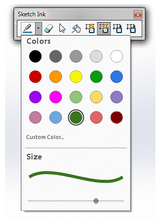

Sketch Ink Toolbar
Visible only on Windows 10:
Setting
Get/Set Methods
Return Value or <Value> or <OnFlag>
Comments
Pen > Colors
ISldWorks::GetUserPreferenceIntegerValue(swUserPreferenceIntegerValue_e.swPenSketchStrokeColor)
ISldWorks::SetUserPreferenceIntegerValue(swUserPreferenceIntegerValue_e.swPenSketchStrokeColor, <Value>)
COLORREF value
COLORREF values in SOLIDWORKS IColorTable; use function RGB to convert R,G, and B values to COLORREF values; the following colors are displayed in the graphic from left to right and top to bottom:
RGB(0,0,0)
RGB(102,102,102)
RGB(153,153,153)
RGB(221,221,221)
RGB(255,255,255)
RGB(204,0,0)
RGB(255,153,0)
RGB(255,255,0)
RGB(0,158,15)
RGB(153,0,255)
RGB(255,0,255)
RGB(147,196,125)
RGB(255,217,102)
RGB(142,124,195)
RGB(194,123,160)
RGB(111,168,220)
RGB(56,118,29)
RGB(224,102,102)
RGB(97,61,48)
Pen > Size
ISldWorks::GetUserPreferenceIntegerValue(swUserPreferenceIntegerValue_e.swPenSketchStrokeThickness)
ISldWorks::SetUserPreferenceIntegerValue(swUserPreferenceIntegerValue_e.swPenSketchStrokeThickness, <Value>)
Valid options as defined in swLineWeights_e:
swLW_THIN
swLW_NORMAL
swLW_THICK
swLW_THICK2
swLW_THICK3
swLW_THICK4
swLW_THICK5
Thickness of pen stroke; if you set an invalid value (<0 or >6) then the pen size is automatically set to swLW_THIN = 0
