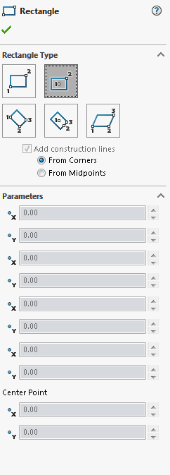

Tools > Sketch Entities > Corner Rectangle or Center Rectangle or 3 Point Corner Rectangle or 3 Point Center Rectangle or Parallelogram
Setting
Get/Set Methods
Return Value
or
<OnFlag>
Comments
Rectangle Type - Add construction lines - From Corner
IModelDocExtension::GetUserPreferenceToggle(swUserPreferenceToggle_e.swSketchAddConstLineDiagonalType)
IModelDocExtension::SetUserPreferenceToggle(swUserPreferenceToggle_e.swSketchAddConstLineDiagonalType, <OnFlag>)
Boolean value
Specifies whether to add construction lines from the corners
Rectangle Type - Add construction lines - From Midpoint
IModelDocExtension::GetUserPreferenceToggle(swUserPreferenceToggle_e.swSketchAddConstToRectEntity)
IModelDocExtension::SetUserPreferenceToggle(swUserPreferenceToggle_e.swSketchAddConstToRectEntity, <OnFlag>)
Boolean value
Specifies whether to add construction lines from the midpoint
