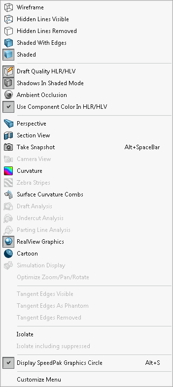

View > Display
Setting
Get/Set Methods
Return Value
or
<Value>
or
<OnFlag>
Comment
Shadows in Shaded Mode
ISldWorks::GetUserPreferenceToggle(swUserPreferenceToggle_e.swDisplayShadowsInShadedMode)
ISldWorks::SetUserPreferenceToggle(swUserPreferenceToggle_e.swDisplayShadowsInShadedMode, <OnFlag>)
Boolean value
Specifies whether to display a shadow under the model
Ambient Occlusion
ISldWorks::GetUserPreferenceToggle(swUserPreferenceToggle_e.swDisplayAmbientOcclusionShadows)
ISldWorks::SetUserPreferenceToggle(swUserPreferenceToggle_e.swDisplayAmbientOcclusionShadows, <OnFlag>)
Boolean value
Specifies whether to use global lighting that adds realism to models by controlling the attenuation of ambient light due to occluded areas; available in all scenes when you use RealView graphics
RealView Graphics
ISldWorks::GetUserPreferenceToggle(swUserPreferenceToggle_e.swDisplayRealViewGraphics)
ISldWorks::SetUserPreferenceToggle(swUserPreferenceToggle_e.swDisplayRealViewGraphics, <OnFlag>)
Boolean value
Specifies whether to display a model with hardware accelerated shaders
Cartoon
ISldWorks::GetUserPreferenceToggle(swUserPreferenceToggle_e.swDisplayCartoon)
ISldWorks::SetUserPreferenceToggle(swUserPreferenceToggle_e.swDisplayCartoon, <OnFlag>)
Boolean value
Specifies whether to apply a cartoon effect to model edges and faces
