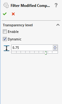

View > Modify > Filter Modified Components
Setting
Get/Set Methods
Return Value
or
<Value>
or
<OnFlag>
Comment
Transparency level - Enable
ISldWorks::GetUserPreferenceToggle(swUserPreferenceToggle_e.swQuickViewTransparencyEnabled)
ISldWorks::SetUserPreferenceToggle(swUserPreferenceToggle_e.swQuickViewTransparencyEnabled, <OnFlag>)
Boolean value
Specifies whether to activate the transparency for unmodified components of assemblies opened in Large Design Review
Transparency level - Dynamic
ISldWorks::GetUserPreferenceToggle(swUserPreferenceToggle_e.swQuickViewTransparencyDynamic)
ISldWorks::SetUserPreferenceToggle(swUserPreferenceToggle_e.swQuickViewTransparencyDynamic, <OnFlag>)
Boolean value
Specifies whether to update the transparency level in the graphics area when the slider is moved in the Transparency Level PropertyManager page
Transparency level - Level ranges from 0 to 1
ISldWorks::GetUserPreferenceDoubleValue(swUserPreferenceDoubleValue_e.swQuickViewTransparencyLevel)
ISldWorks::SetUserPreferenceDoubleValue(swUserPreferenceDoubleValue_e.swQuickViewTransparencyLevel, <Value>)
Double value
Specifies the value to which to adjust the transparency for unmodified components in assemblies opened in Large Design Review
