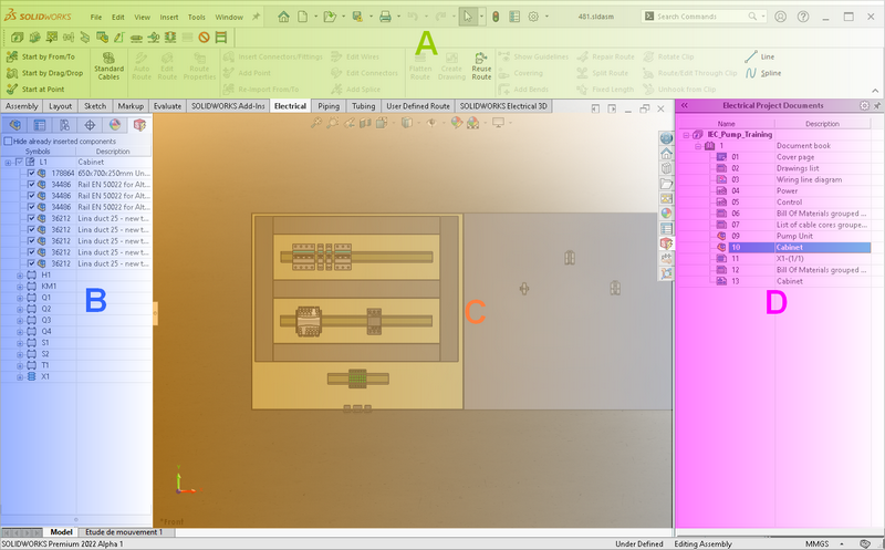

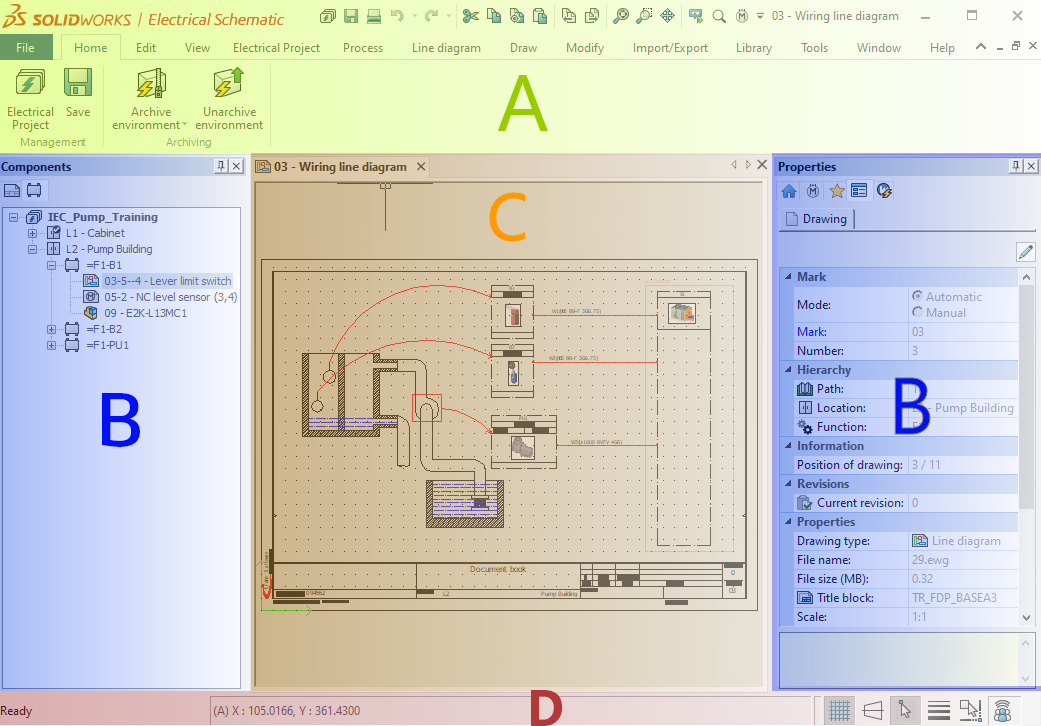

SOLIDWORKS Electrical uses specific panels to help you in your
schematic design. These dockable panels can be placed on the
right or on the left of the screen.
The dockable panels contain different tabs, associated with a specific icon. You can move
these tabs from one dockable panel to the other by dragging
them.
You manage the display of most tabs manually using commands in
the Dockable panels section of the
View menu. Some tabs, such as the
Command tab or Cabinet
Layout tab, open automatically.
You can save the dockable panel layout (tabs and dockable panel
position), restore the layout you saved, or reset to load the
default panel layout.
| Command |
Description |
Electrical Content Portal
Displays the website to
download content. |
Pages
Displays the electrical
project page list. |
Components
Displays the component
list. |
Connection label
Lets you insert a
connection label (Manufacturer part). |
Cabinet layout
Lets you insert 2D
footprints in the 2D cabinet layout
drawings. |
Command
Displays options for the
current command. |
Macros
Displays the macro
palette. |
Symbols
Displays the symbol
palette. |
Properties
Displays the properties of
the selected element. |
Resources |
Displays a group of commands
for accessing commonly used features and online
support. |
In a schematic project, when you set the side panels to
Auto Hide, the panels retain the auto
hide setting.
