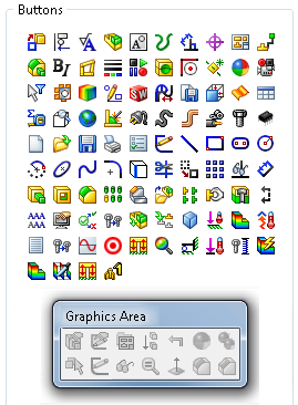

    Below the Buttons area on the right side of the dialog box, a box appears with the default context toolbar buttons shown as unavailable. You cannot remove or reorder the default buttons.
    The label of the box indicates whether you displayed the context toolbar from the FeatureManager design tree or the graphics area.

  4. Under Buttons, drag a toolbar button to the toolbar.
    The software places the button after the default buttons.
  5. Drag additional buttons to the toolbar.
    The pointer lets you control the button placement.
    If you add more than eight buttons, the added buttons automatically wrap to the next line.
