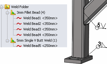

    In this image, there are:
    • Four 3mm Fillet Beads
    • One 5mm Single V Butt Weld

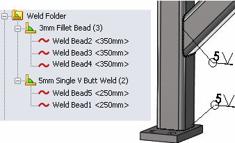

    In this image, Weld Bead1 is moved to the 5mm Single V Butt Weld subfolder.
    A dialog box alerts you that moving the weld bead changes the weld size and type.
  4. Click OK.
    The weld bead moves to the new Weld subfolder and its type, size, and symbol are updated. The Weld subfolder increments by the number of weld beads you added to the folder.
