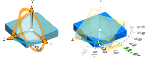

  • Rings
    The ring that contains the X and Y arrows is shown as a full circle. Use it to rotate the selected plane:

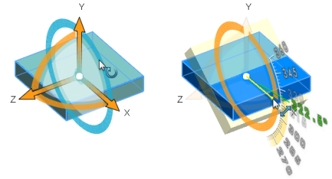

    Rings that are perpendicular to the selected plane are single quadrants. Use them to rotate the model around the axis (in this case Z) that is normal to the selected plane:

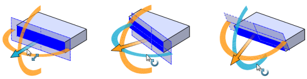

    In the section view triad, 180º rings let you rotate the selected plane or a reference plane:

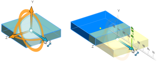

  • Selection handles
    The handles are more visible and easier to drag in the graphics area. Coordinates (X, Y, Z) are shown for each handle. Use them to move the model in the selected direction:
