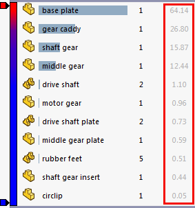

In Assembly Visualization, you can rank components based on the values of their custom properties.
The Assembly Visualization tab in the FeatureManager design tree panel contains a list of all components in the assembly, sorted initially by file name.
To sort the list:
  1. Click a column header to sort the components by that property. For example, to sort by component mass, click Mass.
  2. Click again to sort in reverse order.
