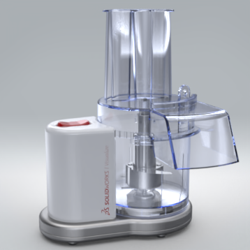

The following image shows typical results with Denoiser off (left) and on (right).
Denoiser Example
In this example, you render a SOLIDWORKS Visualize project, first with the Denoiser turned off and then with it turned on. Then you examine the resulting images and compare the number of render passes, the render time, and the image quality.

    You can open both images of the food processor in your favorite image viewing application. You can zoom in and compare the amount of noise in various areas. For example, zoom to the area around the blade shaft:
    Denoiser Off
    500 passes
    Denoiser On
    50 passes
    Using the Denoiser, you may be able to achieve the same rendering quality with even fewer passes, depending on your goal for the image.
    Actual reductions in the number of passes, and therefore render time, depends on the computer’s hardware and the scene rendered.
